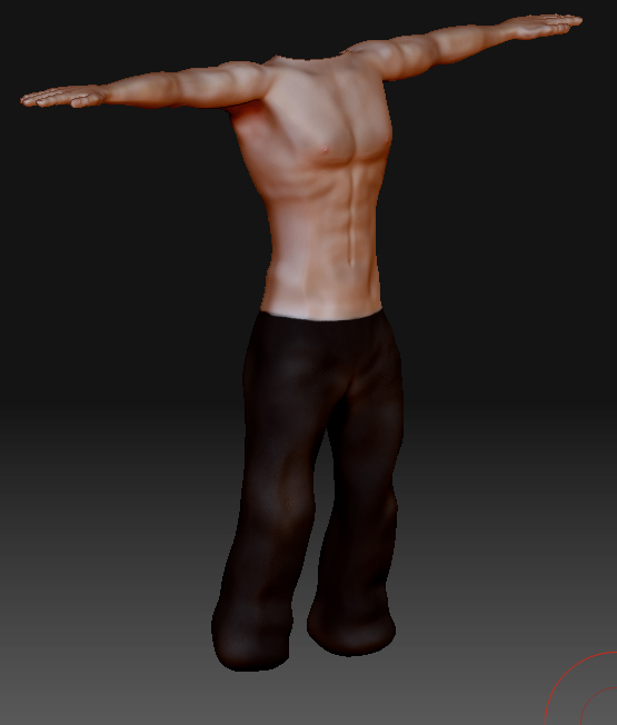

Here’s what it should look like:
http://fux-media.com/3d/cydonia/good.png
And here’s what it looks like:
http://fux-media.com/3d/cydonia/bad-ugly.png
In the ZMapper, the normal map looked just brilliant… do you have any idea, what I’m doing wrong?

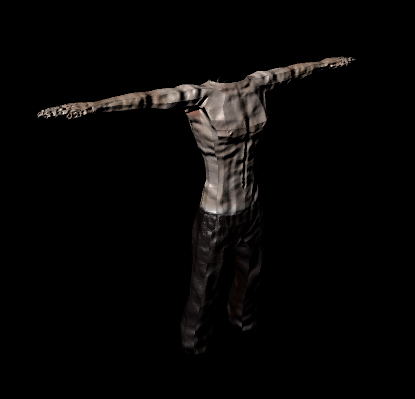

Then, I think your base mesh is not properly planned. In the gaming environment (as far asi i’ve read) , there should be 2 meshes: One triangulated, and one quad-ed, no need for the first be a mod of the second.
The rule of thumb is “Make the silouethe look good, otherwise, no quantity of maps will bring life to your character”
This mesh has only 800 triangles, but the silouethe and the normal maps make it appear as a higher res mesh.
