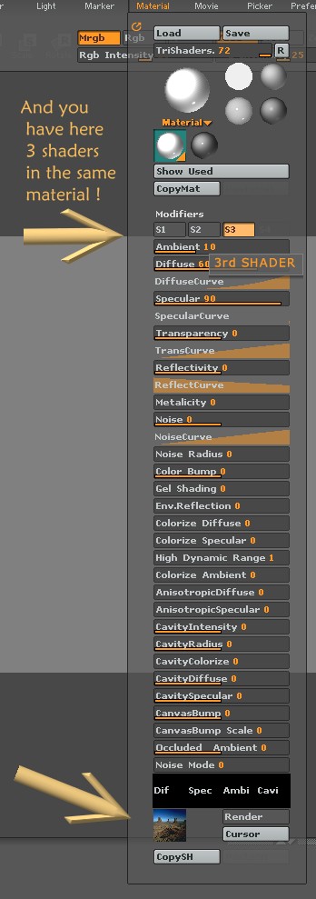

…in some material input any image as component, seems to me that is any problem to make that you show :slight_smile:

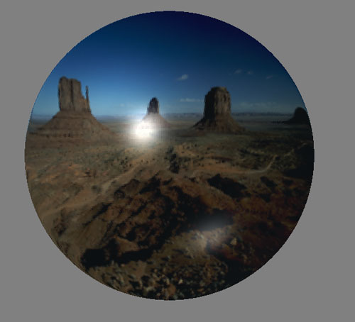

I’ve tried that and the texture reflected in material looks perfect in sphere but
it’s getting distorted in any other shapes. How can I get that distortion off?

Yeah…of course, thanks man. Here’s some images!
The material I'm trying is ReflectedMap and I used the S1 channel. I'm pretty happy with the results so far but the distortion is the problem... [![zpic1.jpg|500x454](upload://eLF3634OHpOleRvRsokRjMwGhTt.jpeg)]![zpic3.jpg|500x454](upload://ws8R2UE71lViUlbJYUgOPE9kV7D.jpeg)

This material essentially places the object into the photograph (or other texture) used in the material. Imagine that the picture becomes a scene that surrounds the object, and the object reflects it.
The distortions that you see are caused by the shape of the object. Any real-world object of that shape that’s placed into that scene would give those reflections. Curved surfaces always give distorted reflections. (Ever looked in a fun house mirror?)
Rotate the model and watch how the reflections change. The ground will always be reflected from the bottom of the object (referring to canvas coordinates here, rather than object coordinates) and the sky will be reflected from above.
