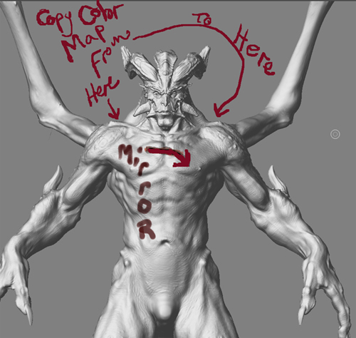

This is what I need,
Josh this model are so nice…
Are you using something like maya or 3ds max, lightwave or other 3d program as well? If its completely symetrical, you could take the model, (the half with the uv’s and texture you want), export it to your animation or render package and then flip it once you are done painting. then you could reimport to ZB to smooth out any texture seams. If you need the textures to eventually be unique on both sides, just make sure to move the UV’s to unique coordinates before you bind the mesh back together. Did that make sense?

As was stated, simply cut the model in half right down the middle in your modeling application of choice. Import the model back into ZBrush and paint all the details on that half. Once completed, export the model and skin out and bring it back into your modeling program. Once there, simply duplicate and mirror the half, attach it and weld vertices. The UV coordinates should be preserved in the process and, thus, your painted map will be on both halves.
