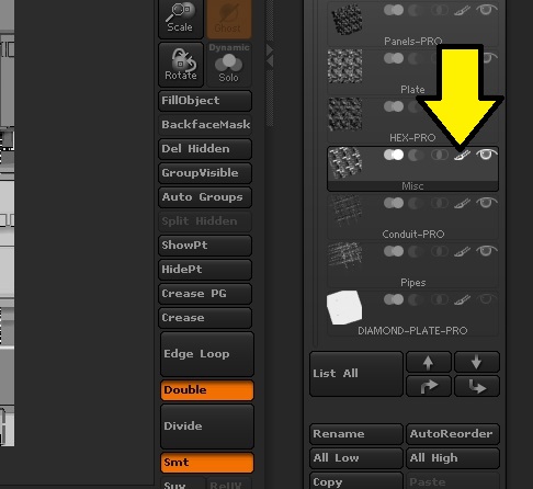

Tried running a Macro to Identify a Command for toggling the Brush Icon in the Subtool Menu to disable texture info Rendering or Displaying, but it doesnt record in the Macro. Looked through the Documentation to find it with no luck. Anyone out there got any ideas. Also will need the command to toggle back on. Thanks in advance for any help
That’s actually the same as the Colorize button so (for the selected subtool) to turn on:
[IPress,Tool:Polypaint:Colorize]
and to turn off:
[IUnPress,Tool:Polypaint:Colorize]
Marcus you are the Best. Thanks for always taking care of the Zscript Newbies
You’re welcome! :slight_smile:
