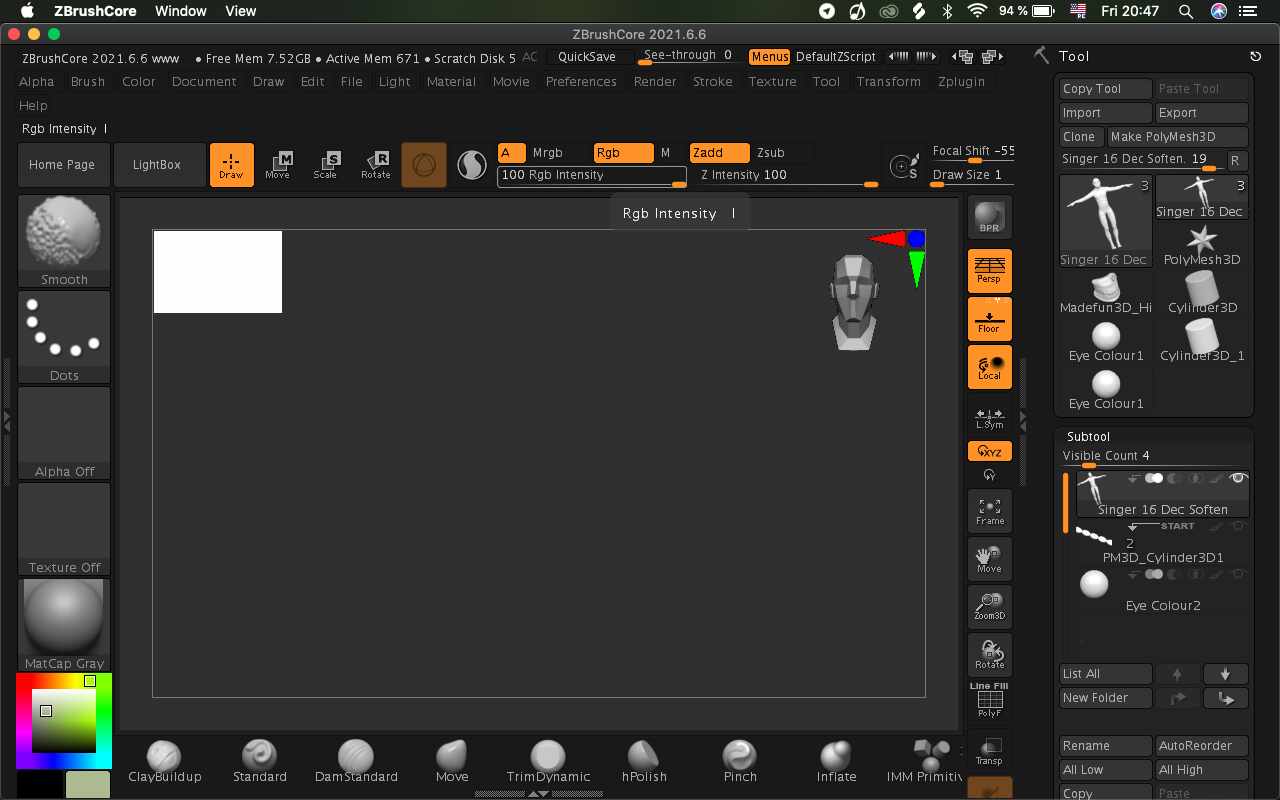

Halo, this keep happening time after time and it is little bit annoying. So I usually rotate my viewport or just tweak some meshes and at one point my model disappears from the viewport and I can not bring it back. I usually than select my model on the side bar, export, create a new project and append everything back. I do know cases such as ‘‘solo button case’’ which is not my case and solution is not helpful. So I keep wondering where do I go wrong hotkeys or do I mask something out or it’s just my cpu? or idk honestly I would appreciate any advice on it.

I use the full version of ZBrush not Core so bear with me if I mention something that is not included in Core. It might be that you have just somehow moved the subtool way off of ZBrush world center. With the disappeared subtool selected, click the “Frame” button (F) to see if you still have the subtool. That will bring it back into view. If it does, zoom out to see how far it has moved in relation to the other subtools. In the full version, you could go to “Tool > Geometry > Position” and just zero out the sliders to bring it back, but I don’t think that Core has that feature. You can go to “Tool > Deformation” and click “Unify” to bring it back but this will also adjust the size to the ZBrush preference of 2.
It totally worked ) thanks much for the reply :grin:
