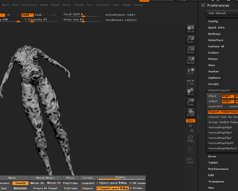

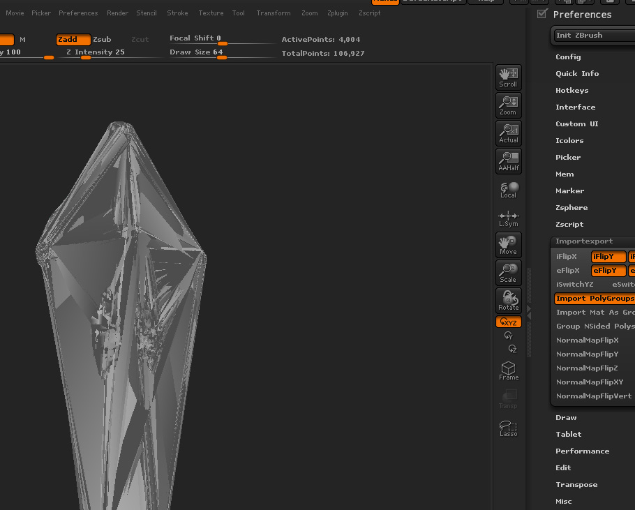

Then when I create the map zmapper goes crazy and make a non-sense maps. (I can use different config it won’t change anything)

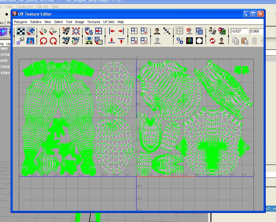

Here are the my uvs in maya 8.5: zbrushforum1.jpg
I’ve been searching the forums for a whole day about this issue…
I don’t care if the uvs are on top of each other I just want a workflow that I can work the texture / model correctly and export normals/displacement and texture map without having to become mad… I can believe how complicated this turns out to be…

ZMapper 3 no longer works with multiple UV groups; you have to split them into seperate meshes
Tool>Polygroups>Uv Groups then Tool>SubTool>GrpSplit before generating normal maps, or you end up with garbage maps.
No, I’ve no idea why something that was working in Z2 is now broken either.
