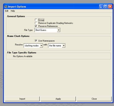

try this in maya import options “create multiple objects” is turned to false
I dont see a “create multiple objects” option in maya 6.5?
I’ll check the zb-maya pdf to make sure I didnt miss anything. The wierd thing is ive gotten this to work once or twice in the past, using the same procedure. Hmmm. =P

its not in the normal maya preferences its in the file menu
file, import, import options. if you do not have this set to false maya will change the vertex order which could be what is causing your problem.

Heres is a screen cap of the import options im seeing in maya 6.5 and 7.

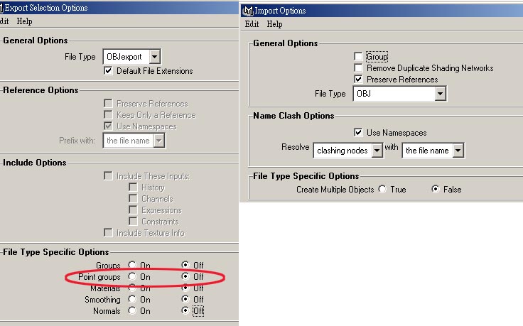

io.jpg try the setting as pic when importing and exporting
Well, damnit, I feel rather foolish. That did the trick. Just had to have obj picked, and then I found that option. Thanks for all the help!
