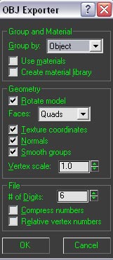

b: You will be promted with this dialog (See pic below):
Use these settings above.
