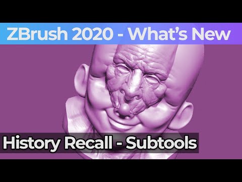

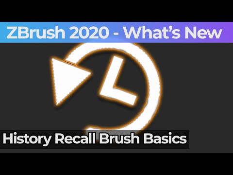

I’m sure the Zproject brush works fine but I’d suggest using the newer History Recall brush. No need to combine subtools. Mark a History point on your detail mesh, move the target mesh into place and scrub with the History Recall Brush. Projects inwards and outwards automatically depending on the relative position of detail and target mesh surfaces. Projection is camera based so don’t forget to move frequently to ensure you’re looking straight down on the model.
Search Michael Pavlovich YT for History Recall. Here’s the first three hits.
Thank you so much, this is exactly the kind of answer I was looking for! I’ve been used ZBrush for very basic tasks since 2014 and never really delved into the powerful stuff until recently.
