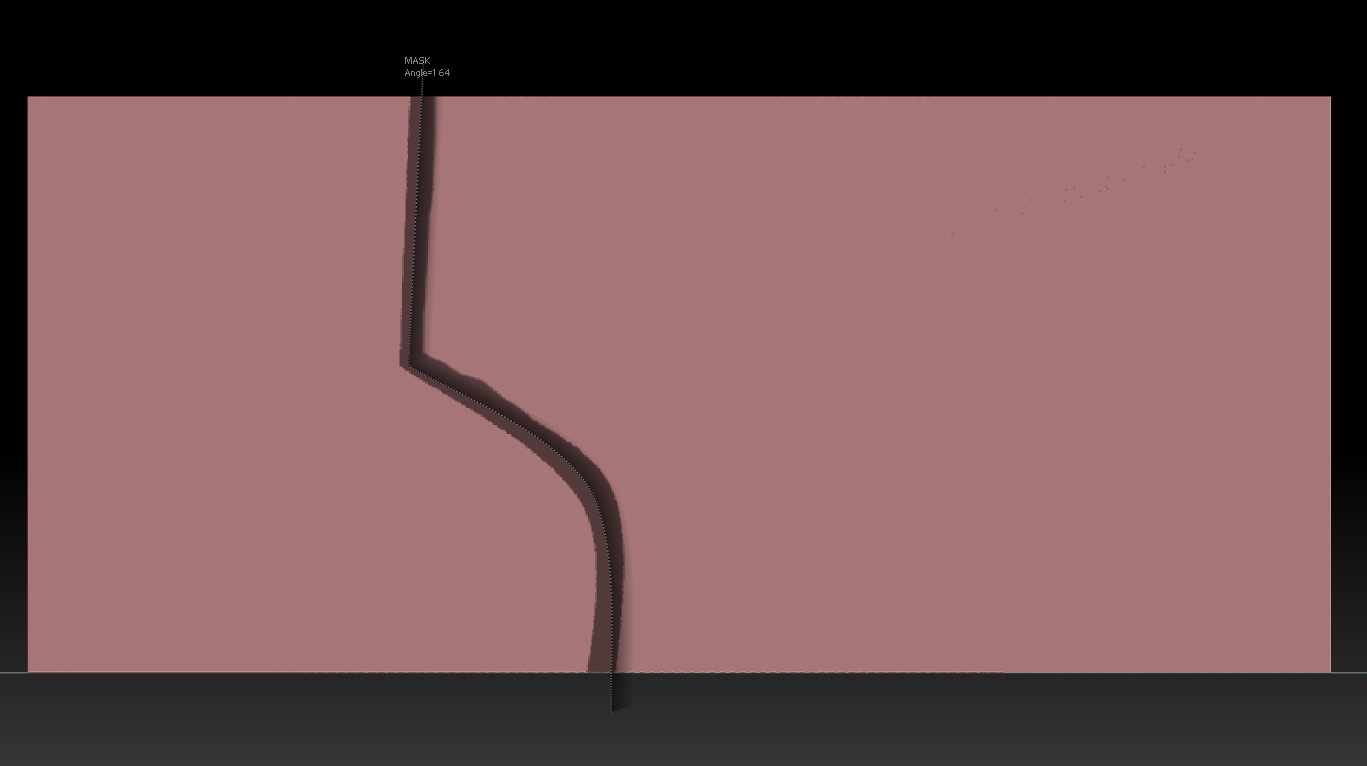

Hi, i was wondering if i can get a mask stroke as a line, line width defined by brush size? i made a crude example what i mean pls take a look.
I would try blurring the mask and shrinking it. That should correct the sharpness of the mask. Now do keep in mind the the overall resolution of the mask is highly dependent on the Subdivision of the surface of the subtool in question. For better alpha/mask resolution increase the sub D of the tool.
Hi gridlost, thnx for your answer but i’ve only put that image to explain what i was trying to ask. what i am trying to achive is that: maskcurve masks everything behind it but i want it to mask as a line stroke (and the line width defined with brush width). is it possible ?

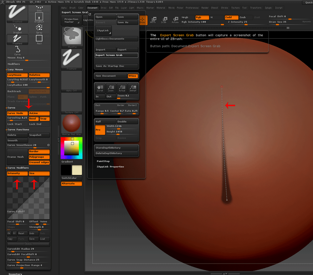

Uncheck backtrack and click curve mode (still STRG pressed :wink: )
Play around with all curve functions.
Basicly you can draw a curve (STRG pressed)
Change brush size and click on the curve to execute the mask.

Here are some pics for working with curve mode:

change from “Freehand” to “DragDot” and you can move your mask with your curve without continuously masking. Use snapshot if you want to make multiple mask lines. You can change brush size inbetween.
Unchack “Bend” to not deform your curve. Sorry for boring all guys knowing this already from polypainting.

Hi Knacki, thank you for your detailed answer. I was aware of masking with a curve but thinking about ergonomics, a maskcurve like function would be mush faster and reliable. I guess i will have to go with the way you pointed out for now. Thanks again.
