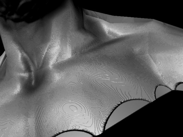

Hi There,
Having created a displacement map and exported it for use as a bump map in maya. Have you ever encounted this problem (see attached Jpeg)?
It looks fine in photoshop yet gives a strange stepping effect when sed as a bumo.
Thanks for your time!
It looks like Photoshop probably resampled it to an 8-bit image. Unfortunately, when Photoshop does this it results in the stair-step effect.
Try using Displacement Exporter to export the map as an 8-bit image. Or simply take your 16-bit map straight into your renderer. (Assuming that it can use 16-bit images in the bump channel. If it can’t, then you’ll have to use DE to export as 8-bits.)
yes!! that right… I have had this same problem on LW, just re do the same thing on ZB, unless your PSD supports 16 bit you will always get the same problem…
good luck
