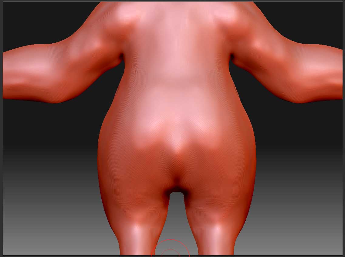

Hi, sorry for the image, not the most flattering view.
I started sculpting at sub-d level 1 then took the detail as far as I could, then went to the next level and so on, but my model still looks lumpy.
So my question is how do people get the mesh to look really smooth. Will a certain brush accomplish this. Holding “Shift” to smooth areas, seems to only work well for smaller areas. What am I missing?
I think you made A TURKEY! HAHAHA! =D
Here’s what you do to get it super smooth.
Switch to one of your lower subdivision levels and then go to the deformation commands found in the tool palette.
Within the deformation commands find the smooth command.
Smooth at 100 in xyz like once or twice, then switch up to a higher subdivision level and run smooth again a few times.
You’ll notice that smoothing on a lower level has a much stronger effect on the overall volume and will smooth those lumps right out.
Also notice that if you have detail sculpted on a higher subdivision level and you go to a lower level and smooth those details away and then switch back to the higher level you’ll see that the details reappear.
But if you smooth on the higher level and then switch back to the lower and smooth and repeat this a few times you can get the details to dissolve away on the higher levels.
You can make macros that help you smooth too. I have macros that smooth at 10X 25X 50X and 100X
Hope this helps. =)
Thanks so much, that worked like a charm. Actually it’s a bear’s behind, but I think it looks more like a turkey too! :slight_smile: I have a few more questions if you don’t mind.
  1. Not sure what you mean by “Macros”. Can you explain?
  2. When smoothing some of the detail in the face disappears. Can I select the face and hide it somehow and only smooth certain parts?
  3. Are there certain brushes that will help smooth areas before I run the smooth deformation?

Oh ok, now that you mention that you’re making a bear, I can see the likeness. You bend those arms down by making masks and using the transpose commands on the upper left, move, scale and rotate.

Thanks DegenerateTriangle, I am using ZB 3.2 mac (sure wish 3.5 or 4 would come out soon! :)) Anyways, thanks for the tips, any brushes you use that would help smooth too!
Spaceboy, thanks for the tip about the “polish” slider. I will give that try.

Yes, there are two brushes that I use from time to time to help with smoothing, aside from the smooth brush, and that is the clay brush and the flatten brush.
The clay brush tends to fill in valleys while leaving peaks untouched. This comes in handy when you want to smooth out areas to the tops of peaks, or in other words fill in valleys.
While the flatten brush is good for filling in valleys while at the same time pushing down the peaks.
Also, there is one other way to smooth that I didn’t mention. Remember when you wanted to smooth out those lumps on your bear? Well you could have used the extract command in the sub tools palette. You would have set the edge smoothness to zero, the surface smoothness between 10 and a 100 and the thickness as zero. This would make a sub tool with the surface smoothed out.
The disadvantage of extracting tho to smooth a surface is, you loose your sub divisions, you normally can’t reconstruct lower sub divisions and you cant hide areas very easily. Well, you can hide areas, but it chops them off in your sub tool result and it’s difficult to reconnect the hidden areas back on your new sub tool.
So you’d only want to use extraction to smooth things in the very early stages of your model creation, if at all.
I just mention it cuz it’s one of the obscure ways to make surfaces super smooth. =)
