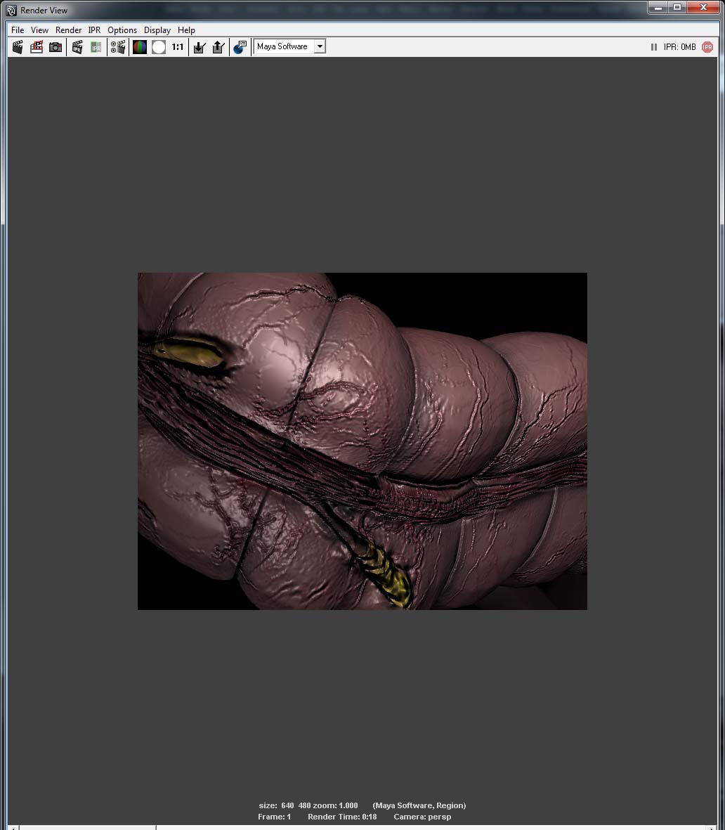

Cool I got it working. However, Any diea why my Object looks like this?
It’s supposed to look like this.
Sorry dude, absolutely no clue.
:cry:small_orange_diamond:cry:small_orange_diamond:cry:small_orange_diamond:cry:
Could this have something to do with my scaling on my displacement map pallet? should I be using 32 bit?
I just Learned… I’m being redundant with my Maps. I should know better.
