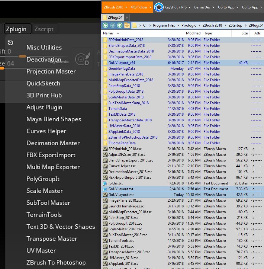

This is not showing in my Zplugin menu (using the x64 version)
Options:
You’ll find the GoUVLayout options under the Zplugin menu.
Hi Sadicus,
I would download the one at the start of this thread.
You may have another plug-in that is conflicting with it, so try the usual process of elimination. Place all the plugins in a new folder, just keeping GoUVLayout. Bootup ZBrush see if it works.
Another issue: Some people can see the plugin interface, but get error messages. I would remove the plugin completely & close ZBrush. Then put gouvlayout back in.
When you go back to the gouvlayout interface and click on send mesh, it will ask you to point the program to the the directory of uvlayout(find the directory) & then it will work properly.
That is all I know & I hope it helps.

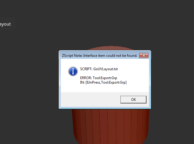

Hi, and thanks for the awesome plugin. Im having trouble in 2021.7. The plugin is loading but it gives error when clicking on it
GoUVLayout_error
It was working OK for 2019, 2021.1. Unfortunately it gives error on 2021.7
Any sugestion how to solve this problem?
Thank you.
Hey Guys, i took the time to fix up the plugin code so it will now works with ZBrush 2021 and 2022.
GoUVLayout-update-ZBrush-2022.rar (22.9 KB)
Hope it Helps !
Nicolas
Thank you for helping. I’ve tryied but unfortunately it gives the same error.
