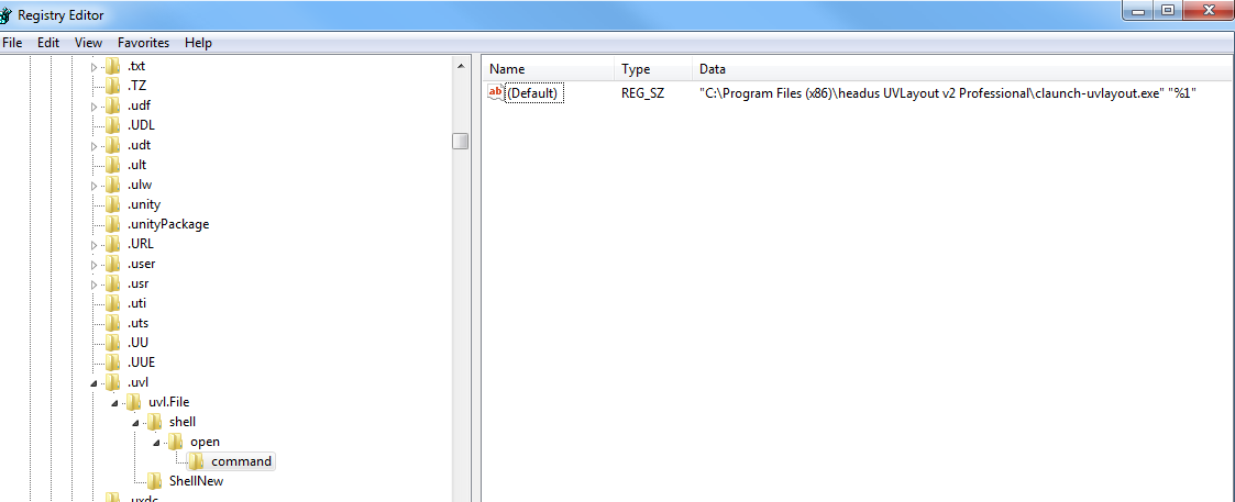

Hmmm, thanks. I’m not familiar with changing things in my registry to be honest. I tried but it’s still not working. This is how things look in regedit. It does seem as if ZBrush is trying to launch UVlayout but it’s not working. The path does seem to be correct as if I type it into windows explorer it launches UVL alright.

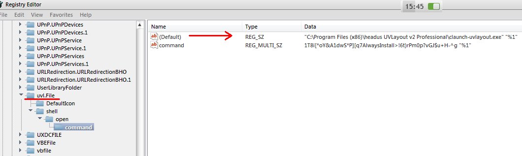

see this regedit path, not .uvl - finde uvl.File
yes! triar is right. You were showing the incorrect path.

Thanks Triar, I checked that path in the registry and the entry is already there, just as in your screen shot but GoUVLayout still doesn’t work here. I deleted the incorrect one I had added earlier. Hopefully the newer version will fix this.

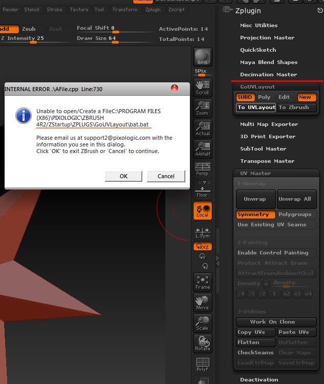

i use ZBrush4r2b now, but in previous versions of Zbrush 4r2, this script does not work.

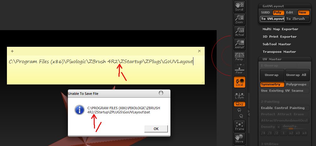

C:\Program Files (x86)\Pixologic\ZBrush 4R2\ZStartup\ZPlugs\GoUVLayout
C:\Program Files (x86)\Pixologic/ZBrush 4R2\ZStartup\ZPlugs\GoUVLayout - in my ZB4R2b…

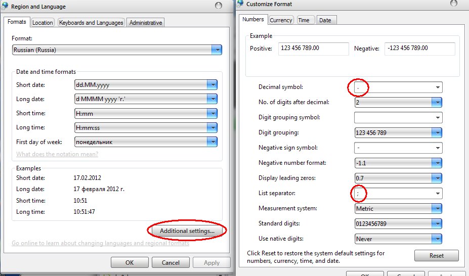

What do you think, whether period or comma in the system to influence this process? Or maybe Eset ESS 4, anti-virus and firewall?
