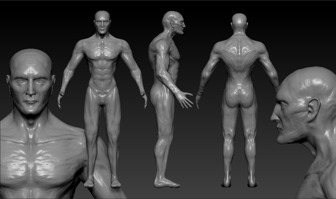

Hi there! Im a student who just started diving into zbrush a couple weeks ago and I’m loving it. Right now i’ve been sculpting a human male character to practice the sculpting brushes and brush up on my anatomy as well. There are some problems with it that I can feel but can’t nail them out because I think i’ve looked at it too long, so i’d love some critique! Heres a wip
This is about 3-4 hours or so of work pushing out a sphere using dynamesh, and insert cylinder for limbs and such. I’ve been in 3d for just over 2 years and my biggest problem has always been going from lower details to high detail and overlooking the middle, so I’d like to polish this character but get all the forms right before so I can break this habit.
Please help! Any critique or advice for moving forward is welcome, and the more the better! :smiley:

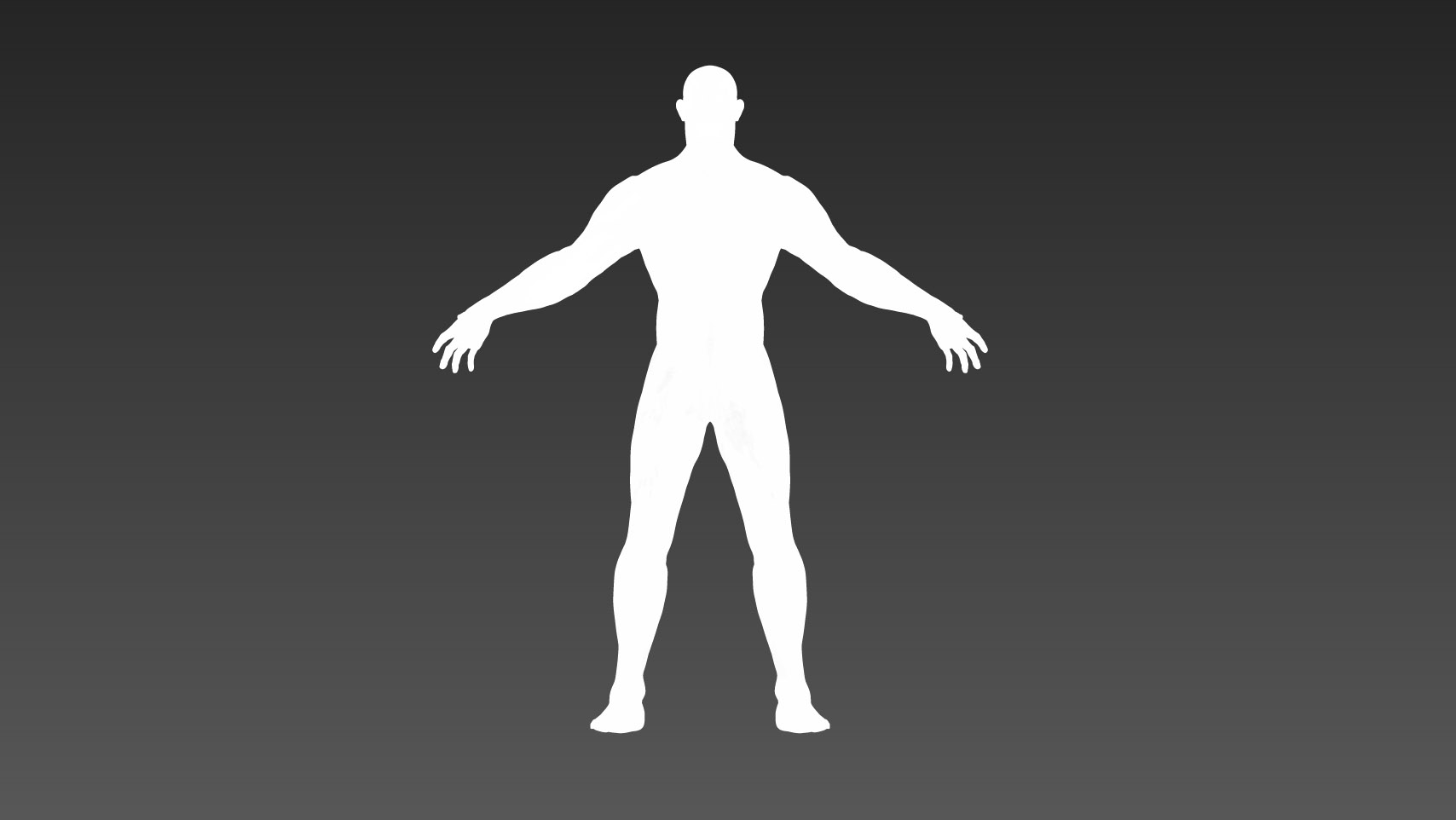

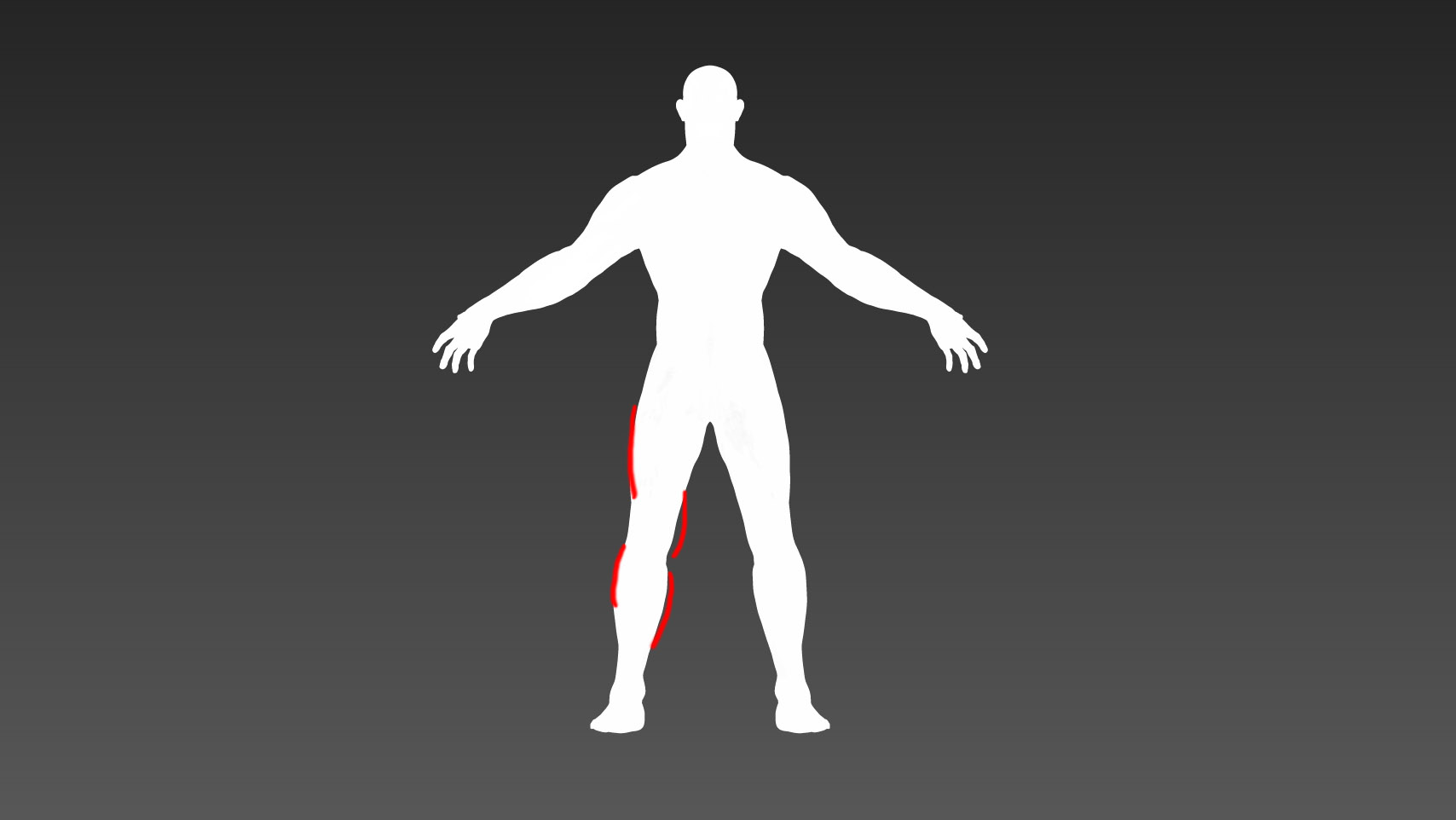

The last thing, regarding the body overall, is that I would advise you to keep in mind the offsetted curves of the human body. They can guide you while trying to achieve a correct and appealing human body. What I mean is for example if we take the legs, you will see that the curves of the exterior are coordinated with the interior curves of the leg. I took a pic with a model done by Scott Spencer. I changed to FlatShader so I can show you the silhouette. Observe the curves of the legs
(note: this model uses the 8 head canon)
In general, is good to look at your model in this flat mode because than you can see if the silhouette gives you enough information and if the curves are where they should be. Also try to use a material with real time lighting such as the basic material. I would recommend basic material 2 because it has a nice specularity that can help if you learn to work with highlights. Most of the MatCap materials (esspecially the red wax) tend to confuse the viewer and to hide certain shapes. They are ofcourse a very nice option for rendering but when it comes to work, try to work with a more neutral and helpful material. MatCap wise, try to get the Mudbox 1 and 2 materials from Zbro. They are some nice materials for sculpting and rendering… this if you really don’t want to use the basic material 2 (which in my opinion is the best for sculpting).

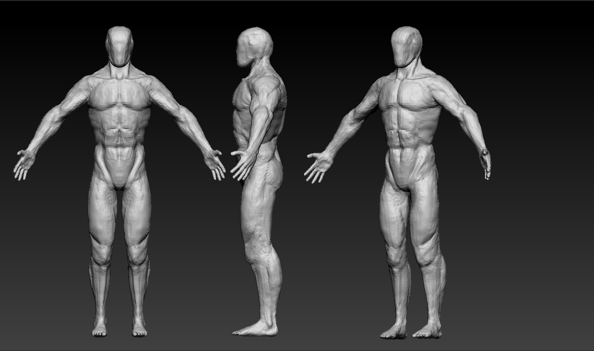

Did some quick movement to get the proportions to make more sense. Was super busy today so didn’t have time to take it into any details but I believe it makes much more sense overall now.
Took all the form suggestions by Yumme into account along with using a better material and using the transpose tool to measure my proportions.
If anyone sees anatomical or proportion problems I would love to have critique as I’m just getting started!

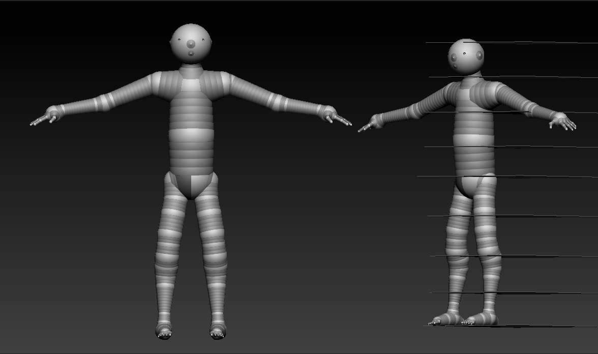

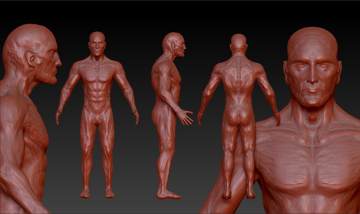

I thought I had put a reply to this post before but apparently it doidnt go through D: I got that book you suggested from amazon and have been going through it, It’s a great resource. I’ve been doing a new male body sketch using the book as a guideline. The progress is muuuuuuch slower but it’s yielding much better looking results, also it started from a zsphere setup so the topology is much better as well.
Zsphere body setup
Initial body mass out after zspheres

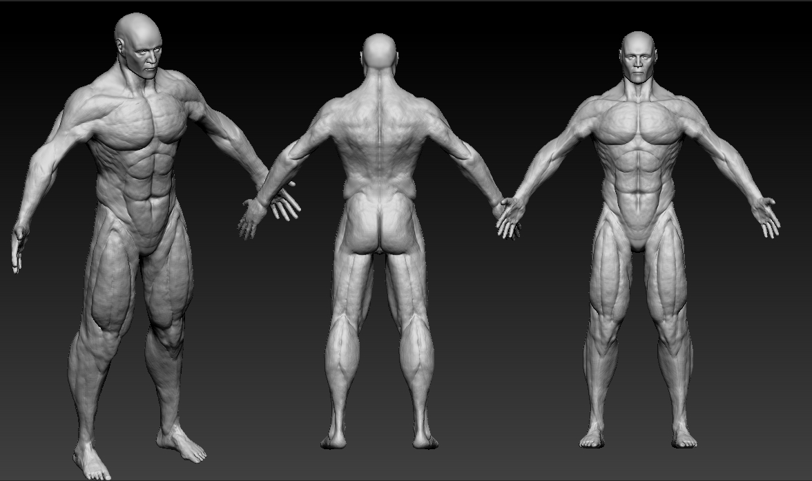

So then I have section by section started detailing out the muscle groups. The target is a ‘heroic’ figure so the guy is kinda big and kinda ripped :smiley: also skin and fat are yet to come:o
I have the all the muscle sections done except the chapters for hand and feet, and then after that is blending of the shapes, fixing up the overall composition, and adding the little details, along with clothing. So far with comparing this to my first attempt at sculpting a body, the guidance of the book has helped me correct anatomical parts of the body that are sometimes overlooked, and allowed me to create a model that each part works together better overall.
In general I am much happier with my results thus far, can’t wait to bring him to a more realistic overall look once skin and fat and final details are done. Thanks for the suggestion on the book Yumme:+1:
