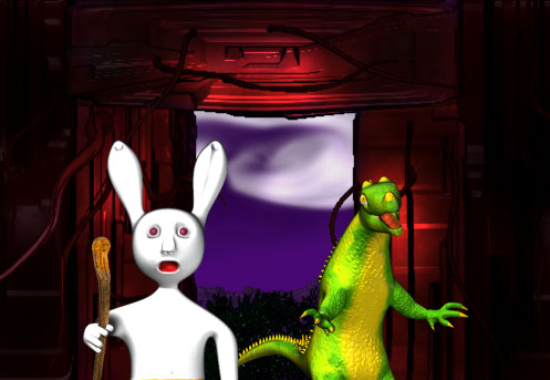

Now I have a background already created and illustrated, One of my characters is holding a wodden torch, on top of which I have to paint the fire.
Now in your tutorial I will have to switch off few layers as the material ball created needs to be baked and fire color information needs to be taken from only ball layer using the other layer option in picker menu.

I am uploading the pic frame though - the wooden torch will have the fire.
It might look some jagged - had to enlarge it for security reasons- so over look that.
[page-9-frame-5-a.jpg](javascript:zb_insimg(‘39068’,‘page-9-frame-5-a.jpg’,1,0))
Aurick do have a look at it

I was simply asking you to have a "visual look at my work, as I haven’t tried that technique before I have no gurantee that it will work on this kind of illustration or not.
You are the right person to atleast tell me it will be time consuming to do this in zbrush or it will be better if I create the effect in photoshop.
I showed this on behalf of your quote - “This is a tough one to answer, really, without knowing exactly what you’re trying to accomplish.”
Now you know what I am trying to accomplish.:smiley:

From what I can see in your illustration, the fiber/smudge technique would create very nice flames. It would probably take more time to do this first time in ZBrush than what you could do in Photoshop. But the result would be a new technique that you can apply in the future to any ZBrush work requiring flames – or fur, for that matter. This same technique has been used for that as well.
Aurick
I will prefer to invest some time doing this in zbrush as it might help me for such works in future.
