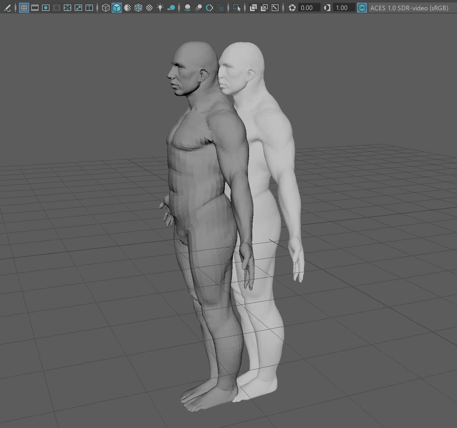

As I explained, to the best of my knowledge it doesn’t if the same procedure is used for both. The following is a screenshot of an imported OBJ and FBX of the demosoldier in Maya:
If your results are differing, I would look at the importer, scale, or import settings in your target application. :confused:
That the demo soldier has the same scale on export is what I would expect. No idea why the model I created from scratch in ZBrush, is behaving differently. It must be indeed a Blender thing. Problem solved, Thanks again Spyndel ! :+1:
