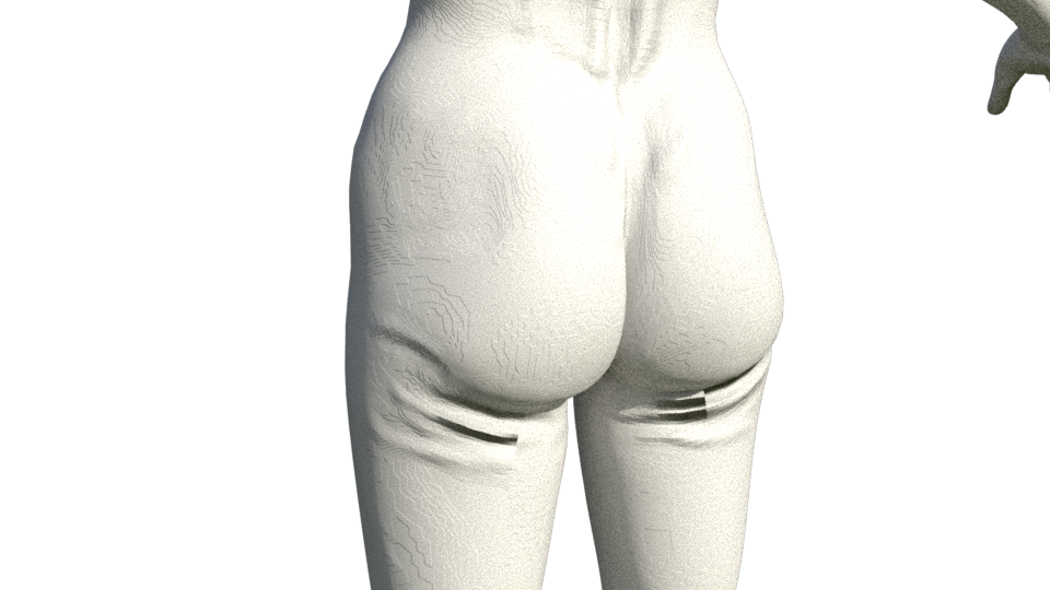

i have big problem that doesn’t let me use normal map in other softwares. Basically i got wierd sharp lines in maya after attaching normal map texture previously exported from zbrush. Anybody know how to fix it?

that’s right what you say, but i have this problem with normal map so i have to attach texture to “bump” mapping in arnold standard surface. There is separated node for displacement map, but only for this. I tried different variations while exporting from zbrush, and normal map looks good in photoshop, but after apllying to maya it is distorted somehow :\
you need to invert your green channel on your normal map from the looks of it.
tried, doesn’t work unfortunetly :frowning:

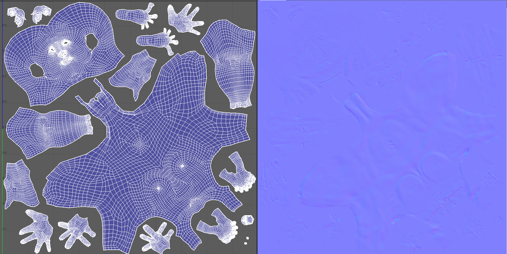

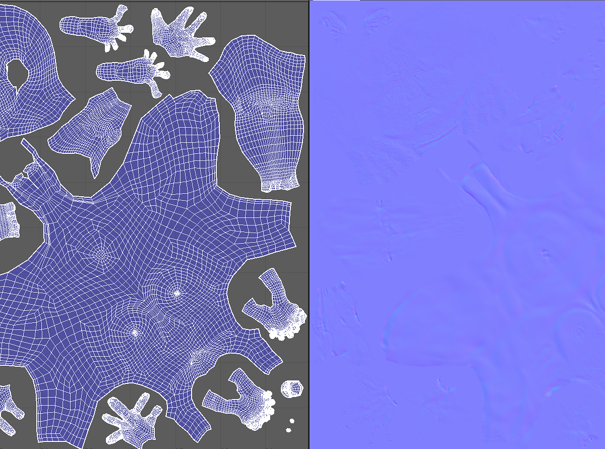

Can you post your maps and UVs? I’m about 90% sure that is either a green channel issue or a stacked UVs during bake error.
Was this baked in Zbrush? Do you get the same error if you get bake in another software?
i didn’t try any other software, because im still learning and i know only Maya for now. here you go,
i did every channel invert and it didnt work, it just changes the direction of those lines, but its still problem there.
Ahh, you baked this in Zbrush. I don’t think I ever actually use Zbrush’s normal maps for anything.
Try baking in something like Substance Painter or Xnormal (free) and see if you get better results.
