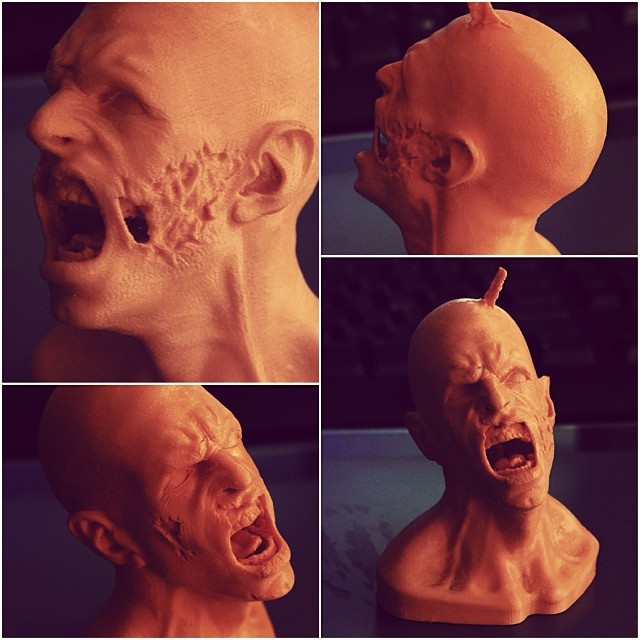

Hi there. These are some of my initial prints using my Ultimaker 2 3D printer
These were printed at 0.06mm layer height.

Ooooh very nice! What are the materials?? And how much did it run, the results look very nice!
Those prints came out looks really nice !, what’s the size of the dog and do you have some images fresh out the printer ?
Sorry, I should mention, top image is a render (if it’s not obvious!)… I didn’t realise it was so much bigger when I uploaded it!

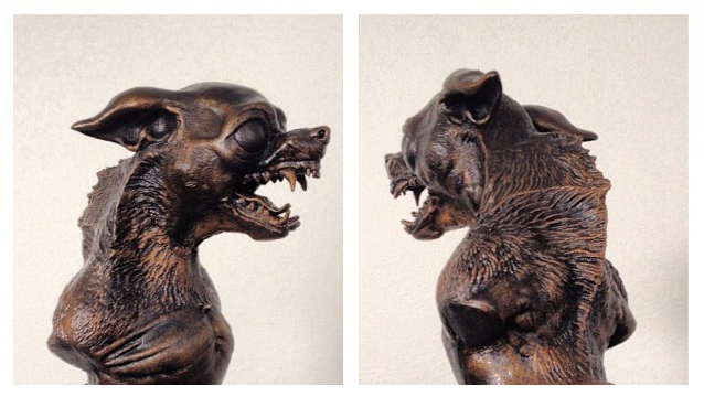

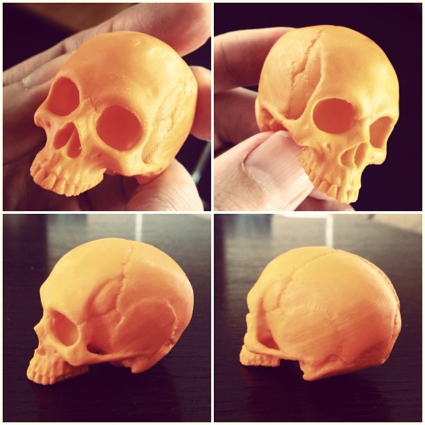

These are just off the printer, the Chihuahua is printed in two parts to avoid overhangs, meaning I didn’t need supports.

These are straight off the printer, printing in PLA. Chihuahua is two parts, to avoid overhangs, no support needed this way.

They look great! If the dog is two parts, where is the seam? I couldn’t see where they were attached in the photos.

Excellent -can you give any details on materials, nozzle size,layer height,etc. What are the rough dimensions of the spiked head?

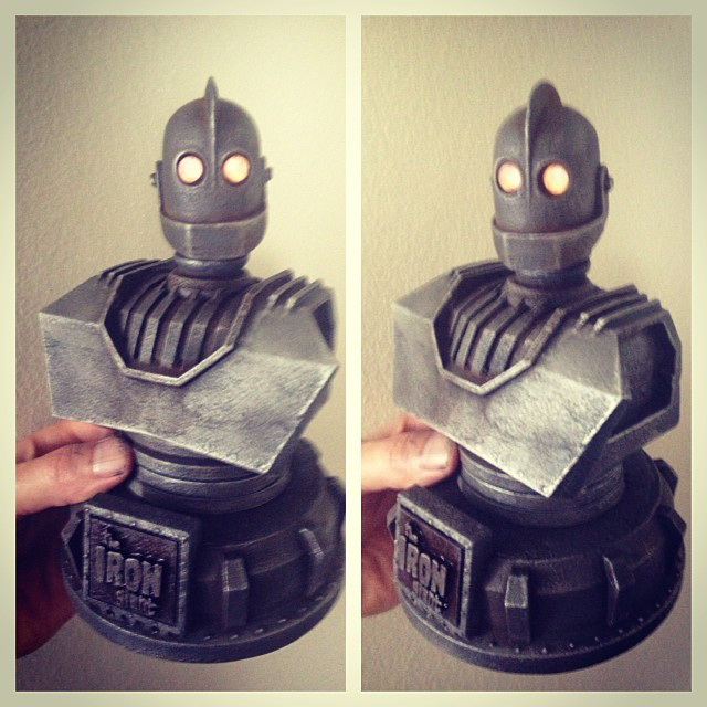

Love the Iron Giant dude!

These are all PLA prints with standard UM2 nozzle 0.4mm. Spiked head was about 70mm I think.
