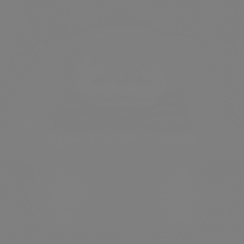

When I try and create my displacement map for my model, it goes through the process of creating it, then nothing happens, it does’t go to the texture channel so I can export it… what do I do?
Zbrush will shoot it over to your alpha pallete, go look there…then you have to select it.
Thanks, I found it now, however when I ever create a displacement map it just turns out blank grey!
Okay, you’re going to have to supply a little more information that what you are. Is it going into another program, what one, how did you create the displacement map, are you using the displament map exporter, etc.
Ok here goes, low poly model made in max, and unwrapped in max, exported as .obj to Zbrush, sculpted detail, went to subdiv level 2, set dispmap size to 2048, DPsubpixels to 2 , Smooth UV OFF then hit create. After creation displacement map is in custom alphas like you said, however almost completely blank. Displacement Exporter won’t work for me, every time I hit create all it says there’s an error.

I don’t think the problem is with max, when I create the displacement in zbrush is when the problem occurs. The map as you can see looks almost blank, even though I have 8 subdiv levels! Weird. Thanks for your help anyway.
I’ve got the exact same problem. the problem is not to render it out in another software, it’s when i try to create the displacement map in zbr.
The alpha just comes out plain gray. any suggestions?

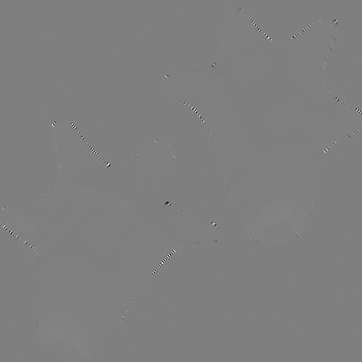

Ahh I dunno what to do man, this it totally crippling my workflow, here’s a displacement I just rendered (dsubpix = 2, map size = 512, smoothuv = on)… this doesn’t look right to me, not to mention the edges are totally screwed up.
try deformation/unify and recalculate the displacement map
Nope, didn’t work…
