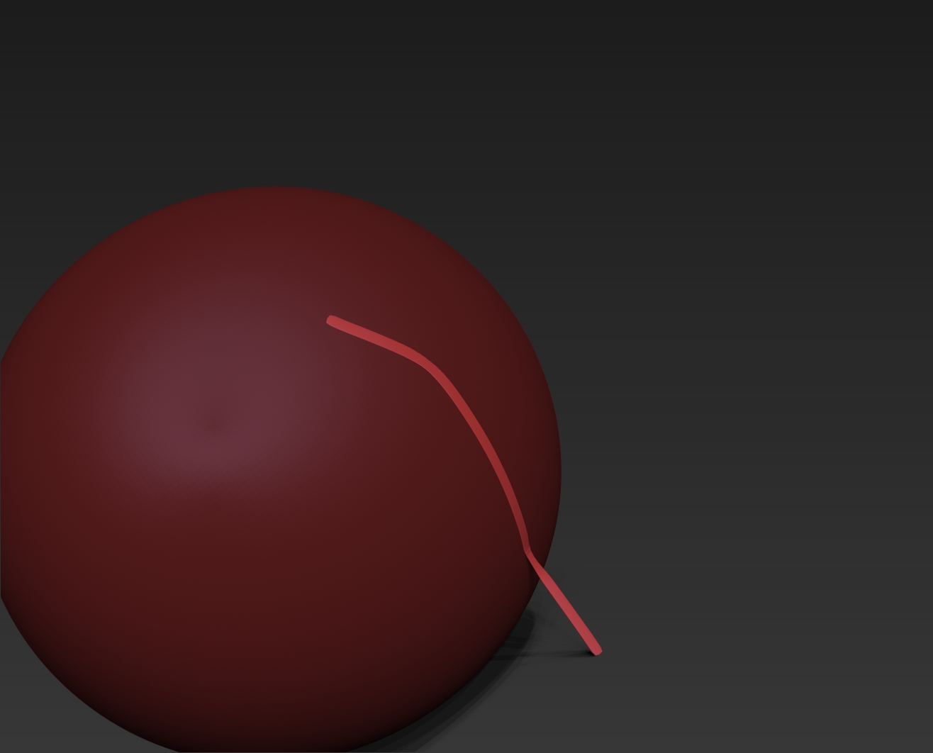

Curve Tube Snap brush gives a Flat plane
When I use the Curve tube Snap brush I get a flat plane following the curve. The Curve tube brush gives me a cylinder.
I tried reseting all brushes. It did not help.

Well after playing a bit longer (I DID try for quite a while before I posted the question…) I noticed my intensity was set to 6 giving me a flat plane. I put it to one hundred and got a tube.
But whenever I start Zbrush it resets the brush intensity to 6 (only on the Curve Tube Snap brush).

As long as you load the default ‘CurveTubeSnap’ brush and change the ‘Z Intensity’ only, you can confidently re-save the brush. Pay close attention to the directory path in step 3.
  1. Draw something on the canvas, turn on Edit and select your ‘CurveTubeSnap’ brush.
  2. Change Z Intensity to 100.
  3. Go to Brush palette and click ‘Save As’ and navigate to ‘ZBrush 4R4/ZData/BrushPresets’ and click on ‘CurveTubeSnap.ZBP’ and overwrite that file.
Now it will be at 100 Z Intensity everytime you select that brush.
