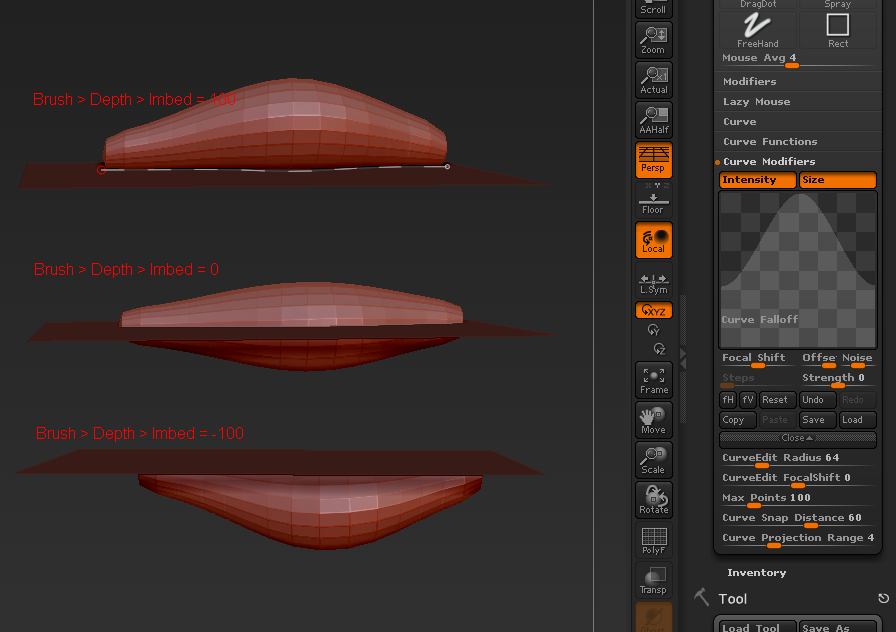

Tablet pen pressure doesn’t affect the width of the curve but you can adjust it by editing the curve in the Stroke > Curve Modifiers sub-palette. You need to turn on Stroke > Curve Modifiers > Size and click the curve to get it to update.
The only setting that affects the Imbed of the curve is the Brush > Depth >Imbed slider. The image shows some different values. You could edit the curve ends from the side to pull them beneath the surface.
