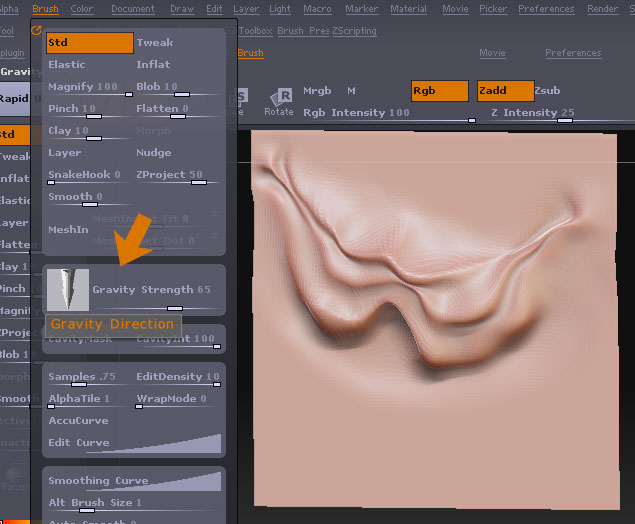

I find that the Gravity option with the Std brush is great for getting a realistic fall to fabric folds. I use a simple alpha like the ‘Brush 01’. Switching between ZAdd & ZSub using the Alt key is very useful - with occasional use of Shift for Smooth.
For pinching folds together the Tweak brush is great but use with care!
That’s basically the method I used here:

Great thanks alot marcus, never even knew about that option (great models btw). Should come in handy, anyone use the pinch brush or is it tweak they use to get the tightness in the edges of wrinkles?
try using masks and dragging folds over with the tweak brush

The pinch brush is a good choice for sharpening the edges, I should have mentioned it.
