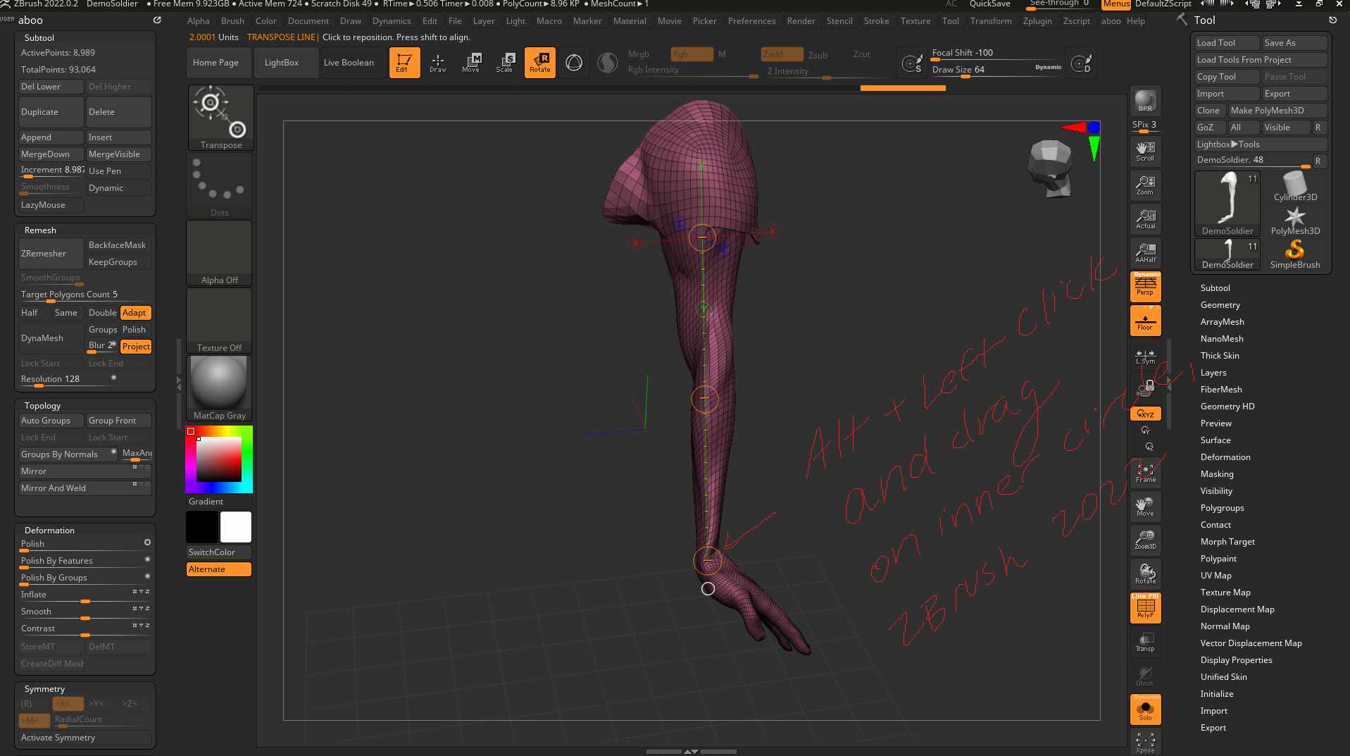

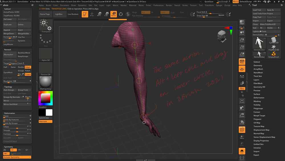

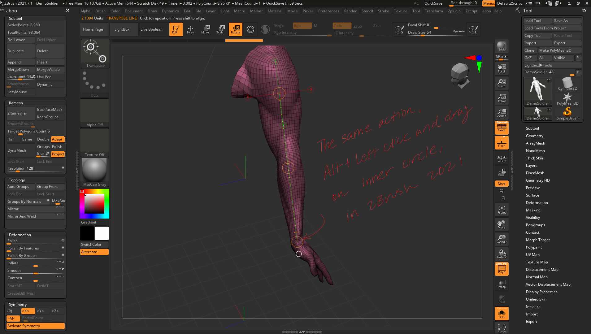

In 2021 holding down the alt key and clicking and dragging the inner red circle of the line’s outer node bent the mesh smoothly past the line; for some reason, in 2022 when I attempt the same action what happens instead is the mesh is skewed in opposite directions on either side of the action line, and simply rotated beyond the action line.
I’ve attached screenshots of the same action performed in ZBrush 2022 and 2021 on the DemoSoldier’s arm with Alt+Leftclick and drag on the inner circle of the outer node of the action line, with the intended effect of smoothly flexing the wrist up towards the forearm.
