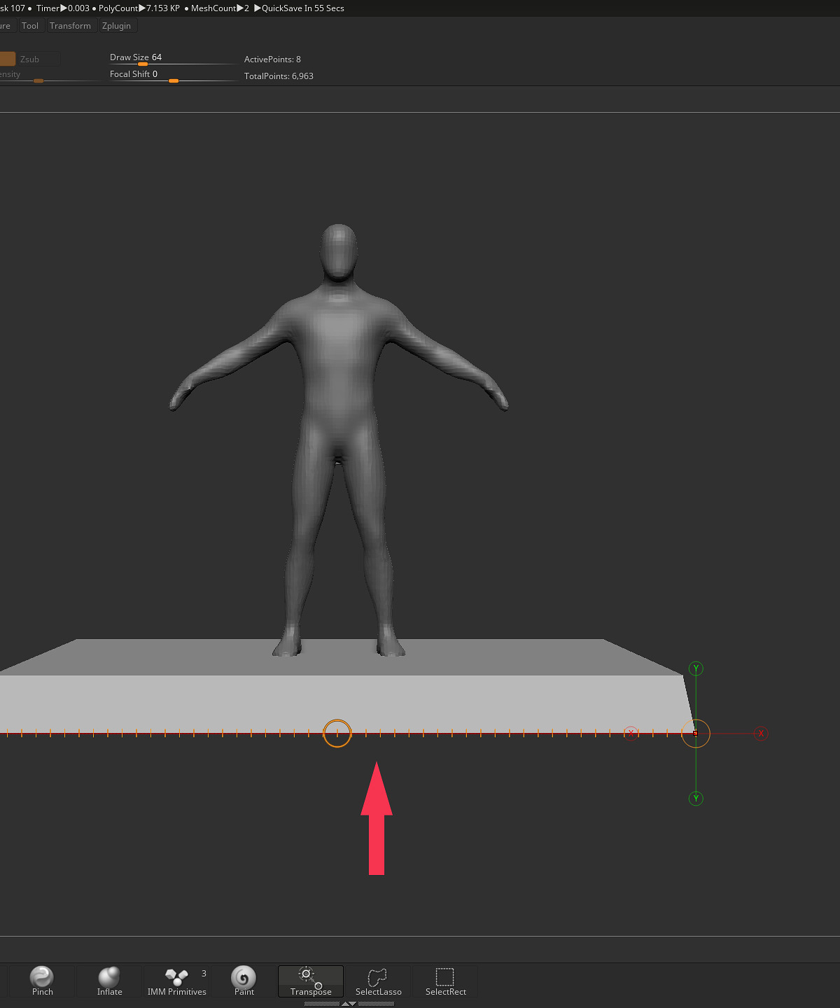

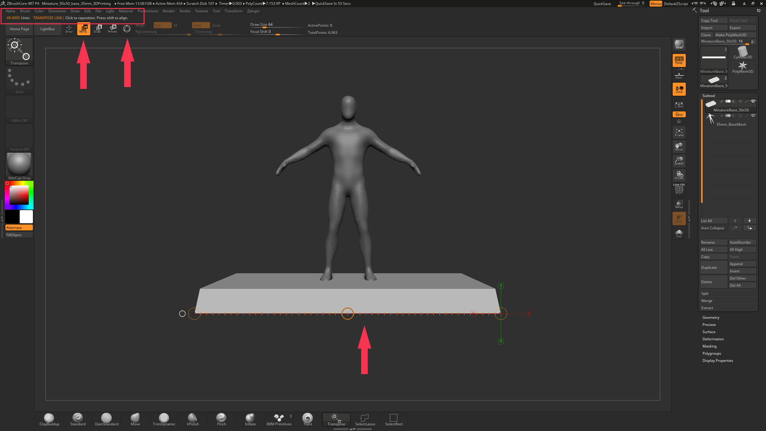

You can use the Transpose Line to measure, as shown in the picture. To access the Transpose Line, turn on Move mode and turn off the Gizmo. You can then draw out the line to get a measurement. The actual measurement is show in the NoteBar, top left. (If you wish, you can set the units displayed in the Preferences>Transpose Units sub-palette.)
