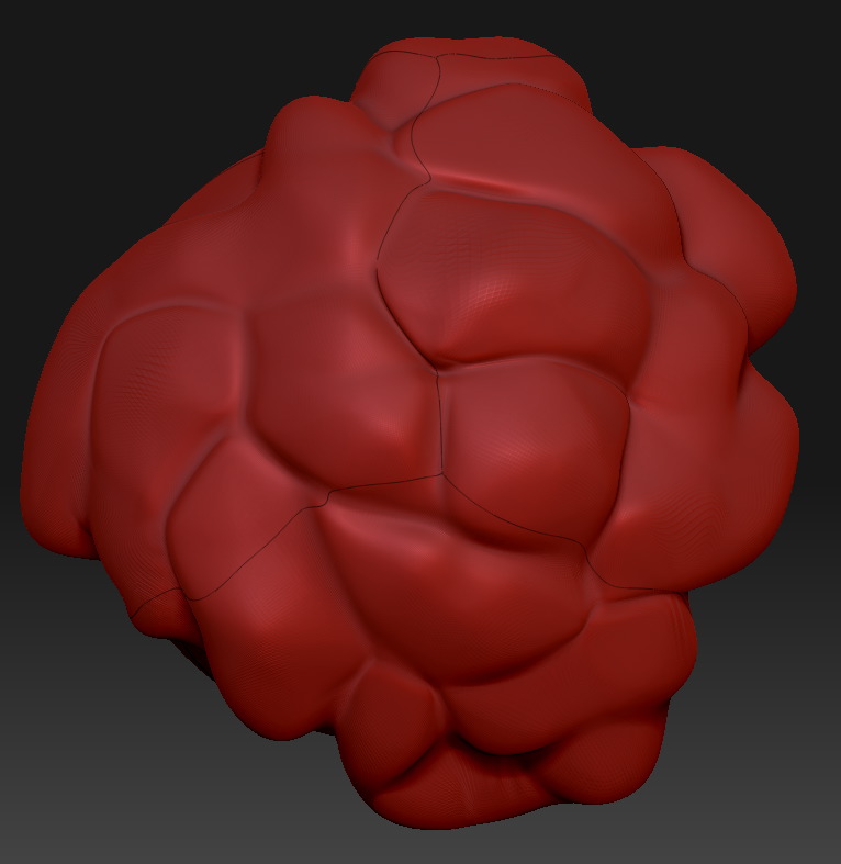

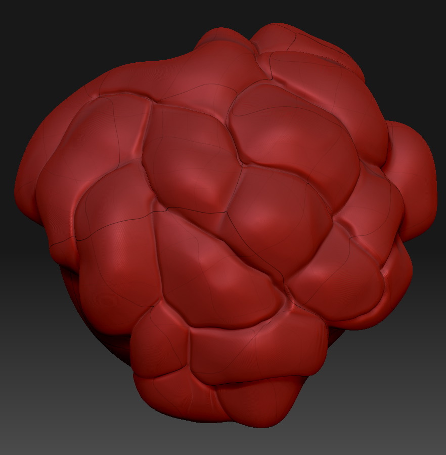

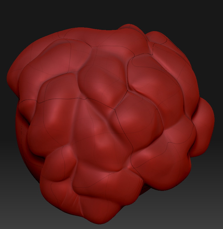

you could sculpt that by using standard brush and inflate to get the bulges, and then use the pinch brush to squeeze them closer together in the seams. I used a similar method for doing intestines :slight_smile:

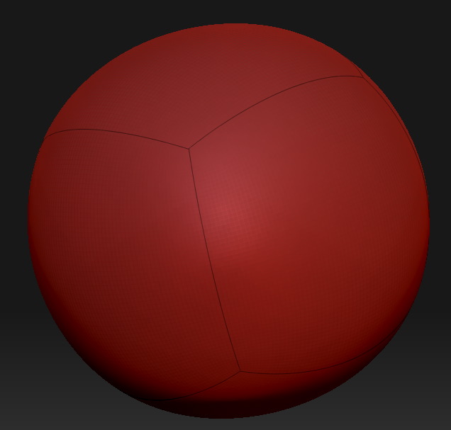

Here’s a test I did in about 1 minute on a simple shape. I started off with my quad sphere, used the standard brush and quickly drew in some bulges. Then I used pinch brush to squish them together more and smoothed it out a little if it got funky. Then I used inflate to round it a bit more. lastly I used a damien standard brush to deepen the crevices and pinched some more.
Keep in mind I did this very fast so it’s not supposed to look pretty. You could even just use damien standard to carve the grooves initially and then inflate the other parts. so they bulge out more.
