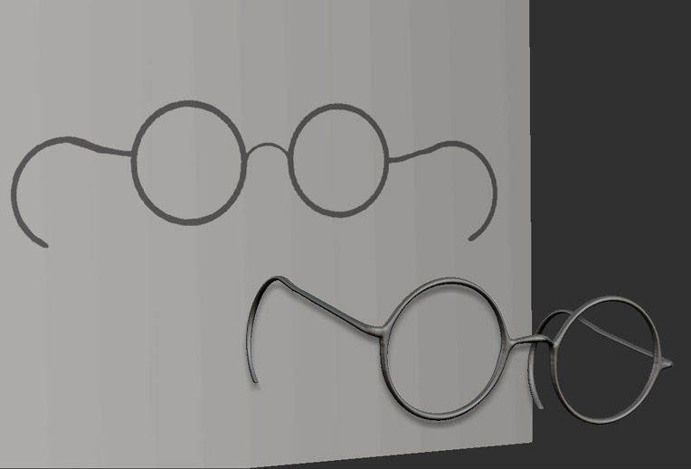

@ spaceboy412 Could you do a time lap video of your way of doing a pair of eye glasses? Just normal round lens and arms that curve at the end over the ear.
i used Alpha 09 as a mask, and an extraction on a polyplane of 1mil polys. and was very lazy and imprecise with the arms but whatever.
then used transpose to move the arms back. if i had drawn the mask on a cube i wouldn’t need to do that.
took less than 3 minutes, sorry no vid.
yes its fast and ugly, but for an illustration it would be fine. you didn’t specify what the outcome is needed for and that dictates much of ones workflow.
