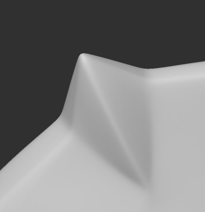

Hi. Im trying to bake Displacement. Main issue is that after Dividing my Lowpoly mesh is changing and a bit different from what i started (Dividing is pretty differentfrom “Turbosmooth” in 3ds max).
I tried “Cage” button at 1st SubD level and this brought back my initial lowpoly form BUT! this changing my HI-Poly. So now after “Cage” Onn. when i switched to last SubD level, my HiPoly looks weird.
How can i solve this problem?
For Example. This is normal Hi poly.

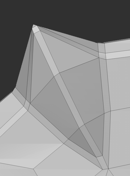

This is 1st Subd Level.

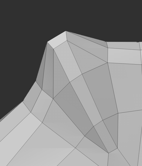

This is initial geometry with Cage on.

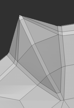

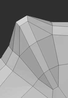

This is happens after Cage at last SubD level. Edges are changing a lot.

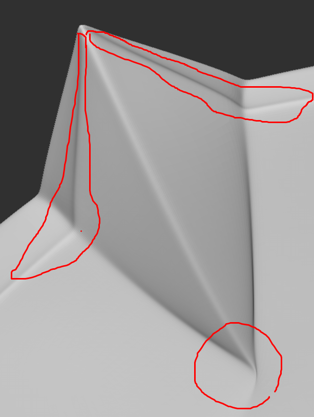

Also after this manipulation, now my Displacement is clear grey. Nothing baked.
