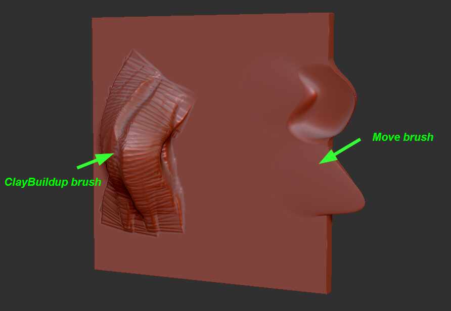

I see. How about the sensation i described where it feels like im dragging my model rahter than adding clay to it? Is that most likely to be a setting issue i’ve overlooked?
I’m not quite sure what you mean by “dragging”. If you could post a screenshot, that would help. It might just be the brush that you are using. It sounds like you’re using the Move brush. The most common brush for “adding clay” is the ClayBuildup brush or Standard brush.

Its the standard brush I’m using. I’m in the midst of resetting up the mini core so I cant provide the img right this moment. But It seems that in the Licensed version of Zbrush, the ‘standard’ brush doesnt seem to work the same way as it does in The mini.
Hi @DSDirt
I’m also not 100% on what you mean here, but I’m going to guess you are referring to Sculptris Pro. Sculptris Pro is enabled by default for the Standard brush in CoreMini, but this is not the default mode for ZBrush.
Sculptris Pro adds new geometry to the mesh in real time to keep the polygons from stretching out of shape. In ZBrush this mode is not on by default as it alters the topology of a mesh and this is not always desirable. The classic sculpting mode in ZBrush merely displaces the points on the mesh but does not add geometry. On a low resolution mesh this can result in polygons quickly being distorted out of shape, which will be apparent on the surface of the mesh.
The button for Sculptris Pro mode is found next to the Gizmo 3D button at the top of the default UI ( or use the \ key). It can be activated for many but not all brushes. It is most useful when quickly sketching out form at low to medium levels of detail such as you do in CoreMini, but it will not perform well on high resolution meshes or when sculpting the finest detail. In those cases you want a highly subdivided mesh with clean quad topology and a brush in normal mode for the finest detail.
