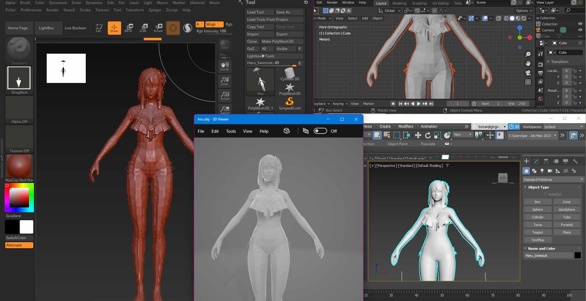

I have found where the ngons were located upon remembering they were caused by me dividing polygons at some point and now have been fixed.
I have tried add subdivisions using D but it just cuts the model into pieces, I’m looking to learning to fix holding edges and get back if needed.
I do have an album of images covering what attempts i’ve made: https://imgur.com/a/YJUt1Vb
Edit: after viewing my .obj in windows 3d viewer, it’s the triangles that are the issue here. I’ll try to look into that instead since I don’t really know anything.

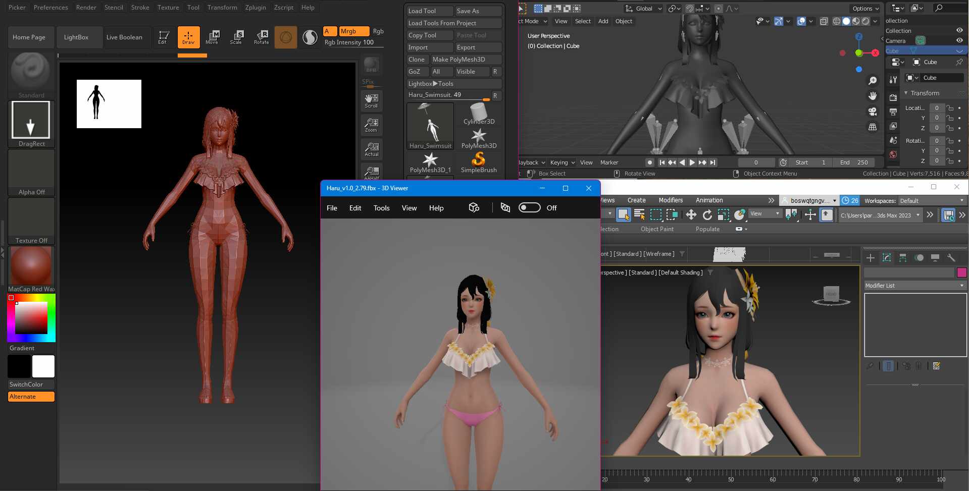

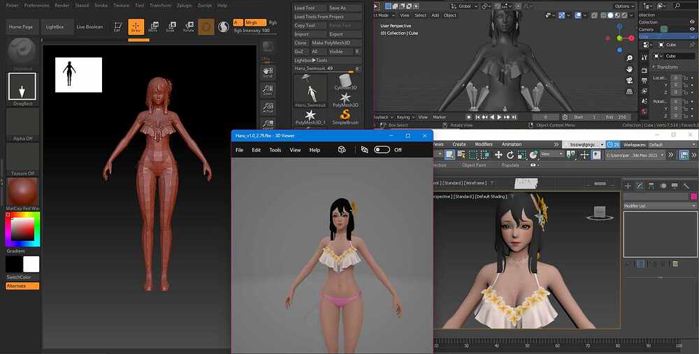

Sorry about that, i’ve also looked into my issue some more with someone on reddit and we’ve come to the conclusion that this is happening purely because the models are too low poly.
fbx ver
obj ver, retriangulate polygons turned off. Only 3dsmax 2023 's version has smoothening.
Am I supposed to simply move elsewhere if i don’t wish to start from scratch? and of course find a 4-faced polygon if I do plan to make something from scratch in Zbrush to avoid this in the future?
