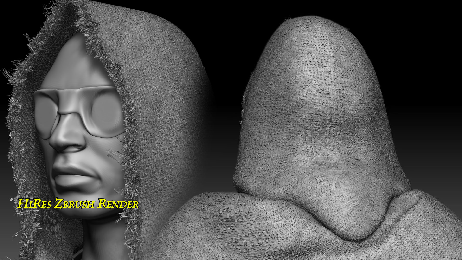

To create a thinner weave, you have to go back to the original weave mesh and modify it and then reapply it to the target mesh. I went ahead and modified one for ya, hope its the look you wanted.
Here’s what the modified mesh looks like.
Here’s what it looks like on a Plane 3D subdivided once and Tore it up a bit too.

Also to get more of a wire effect is to reduce the polygons on the target mesh by lowering your subdivision levels, if you have no lower subdivisions use ZRemesher to reduce it. Micromesh is going to produce a mesh for every polygon on your model, so if your mesh is dense your going to get a lot of micro meshes. You can see my example below shows a Plane 3D with a little sculpting on it. Each has a higher subdivision on it with the same micromesh and you can see the results. Hope this helps you out.

Experimenting with NanoMesh instead of MicroMesh has proved to be very versatile for this Technique. I have some Examples Below and a New Tutorial will be coming Soon.

Finally had Time to sit down and do the Tutorial. In this Video I’ll show you how to create a Torn/Worn looking Material on the Clothing of your Character using the Versatility of Nanomesh. Also show you how to set-up a Material in Keyshot to bring your Renders Over the Top.
