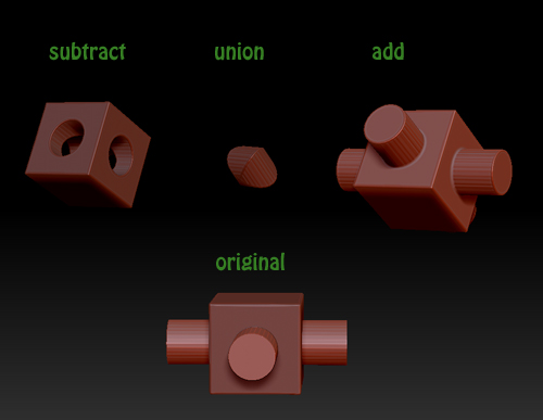

The name of this picture is “if I can do it, you can, too!”
Process:
I drew out a cube and put it into edit/makepolymesh
I added a cylinder as a subtool
I hit unify on each of the above (I don’t think it did anything in this case)
I resized the cylinder using deformation palette so I wouldn’t make anything wonky
I duplicated the cylinder and rotated it 90 degrees
The Cube was going to be “acted upon” so it was at the top of the stack and overlapped double white circles/boolean add icon was pressed.
Depending on which outcome, I then either set the remaining “actors” to add (same as above) or the other two options - subtract and difference.
I took a wild guess at the resolution and smoothing settings and made certain x, y and z were greyed out before I pressed remesh all since I only wanted the simple effect on the top subtool without mirroring in any direction. (I’m guessing mirroring is what these axis buttons do…someone chime in if I’m wrong here).
Any subtools that are not visible will not effect the remesh.
Edit to add that I may mis-spoke in that photo. I’m pretty sure that isn’t UNION but actually INTERSECTION as the correct terminology/action.

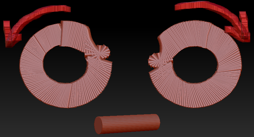

I think I am starting to see my problem and its got me a bit confused, it happens in 2.5D and 3D.
What is going on is almost like some part of the third dimension is missing, like you can rotate something 359 degrees and when you are almost to 360 it whips around to 0. Or something…
I have been seeing this for a while, since I started using Zbrush actually. I first noticed it when (and this still drives me nuts) what I am working on gets stuck upside down. I have to sit there and carefully rotate it 90 degrees at a time till it stops flipping 180 and then I can get it facing in the direction I want.
Even more interesting is that this does not happen in Sculptris, if I rotate something in Sculptris it just rotates, I dont have to think about it or put any work into it, it just does what I expect it to.
How this is effecting Subtools Im not sure, but I can show quite clearly there is some sort of issue here with a picture.
Does any of this make any sense at all?
This is a simple example, each of the two circles were drawn in the direction of the rather poorly drawn arrows, as you can see there is a point where Zbrush flips out and spins the brush (that cylinder at the bottom) back around to I’m guessing 0 degrees.
This happens with everything on all three axises (2.5D and 3D) and its taken me a long time to realize what I am seeing.
There are other oddity’s like the more depth (in and out in relating to the surface of my monitor) the smaller my work area becomes till its a tiny dot in the center…
Is it me, Zbrush or both?
