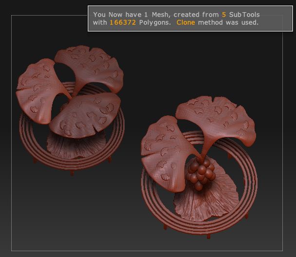

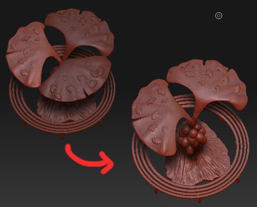

Now it works! (1.26) Thanks man :slight_smile: :+1: :+1: :+1:
Only problem is when there are repeated name for subtool, the repeated one will not be included in the final result. So all I had to do was renaming so there will be no name conflict.

This is the result… Thanks :slight_smile:

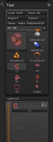

Subtool name 00, 01, 02, 03 ,04, 05 —>> 04 ??? :eek:
Hi, Game Master 770
My ZTL File!!!
ancomic, I managed to reproduce your error. Another visibility flag I had not seen before, which I fixed to check for simular flags I had not run into yet, as well.
The updated version 1.26b seems to run your mesh ok, but on repeated use, it will run into name duplication problems. On a fresh run of Zbrush, there should be no problems. For now this naming conflict will be listed as a known issue.

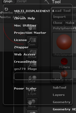

version 1.26b Zplugin submenu ???:eek:
Your small mistake? :slight_smile:
Yep. :rolleyes: Corrected now.
I downloaded and installed 1.26b and get this in the zplugin dropdown menu.
Previous versions were ok. ZBrush 3.1 WINXP.

Try re-downloading it. the first copy of 1.26b had a typo.
It works, but the button is not in the plug-in area, but in the script area, at the bottom of GUI. Download again, to avoid the hassle.
That did the trick :+1:
