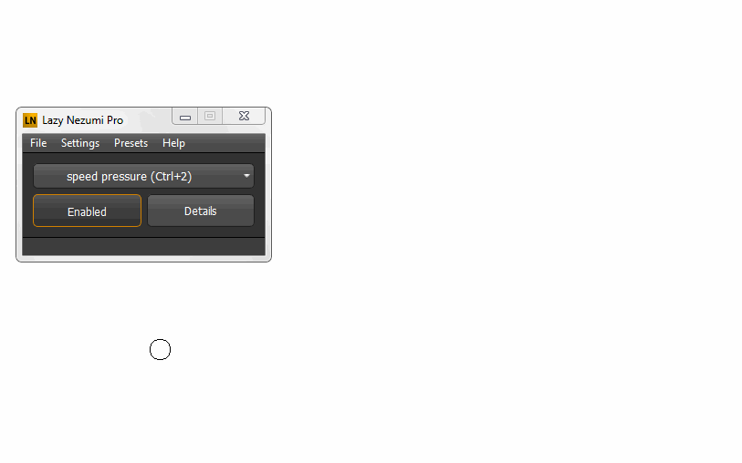

Here’s a little demo of the new Speed Based Pressure Scaling feature in action. Notice how the line gets thicker towards the end when I speed up!
