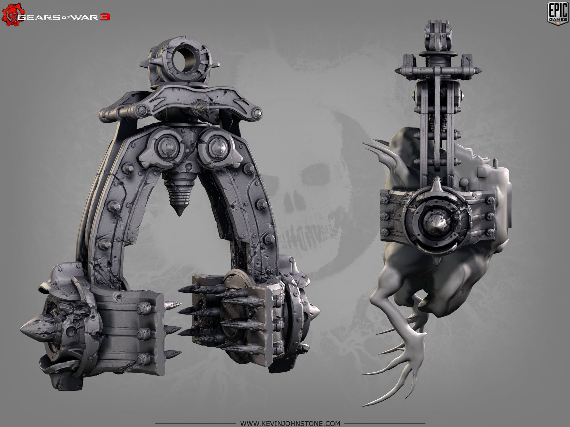

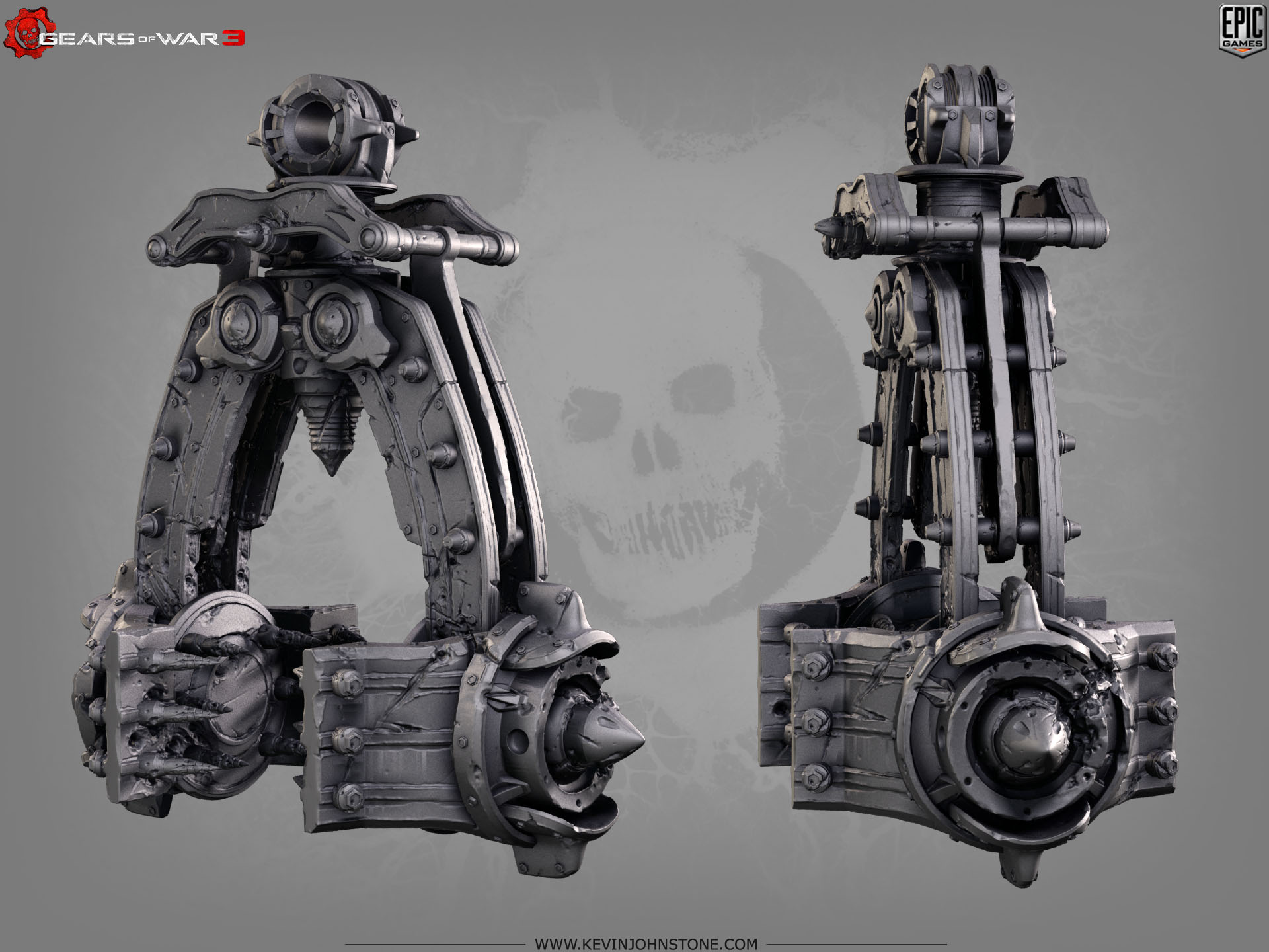

These were the exploded versions of the ticker clamps

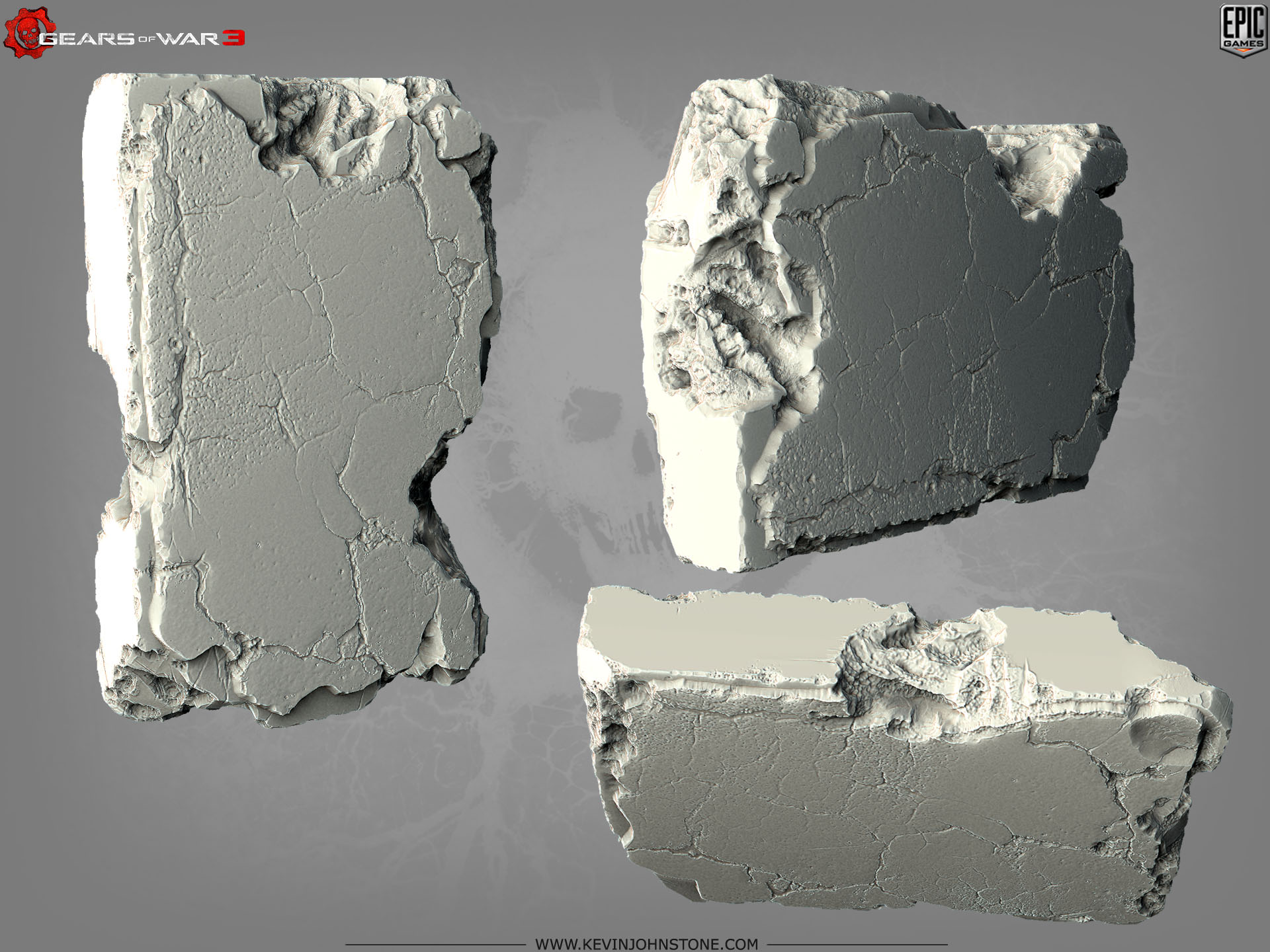

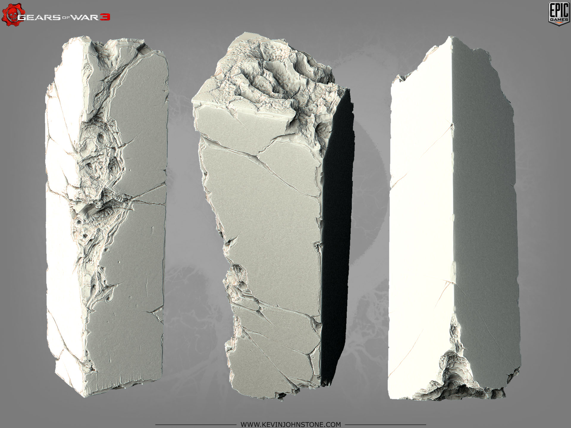

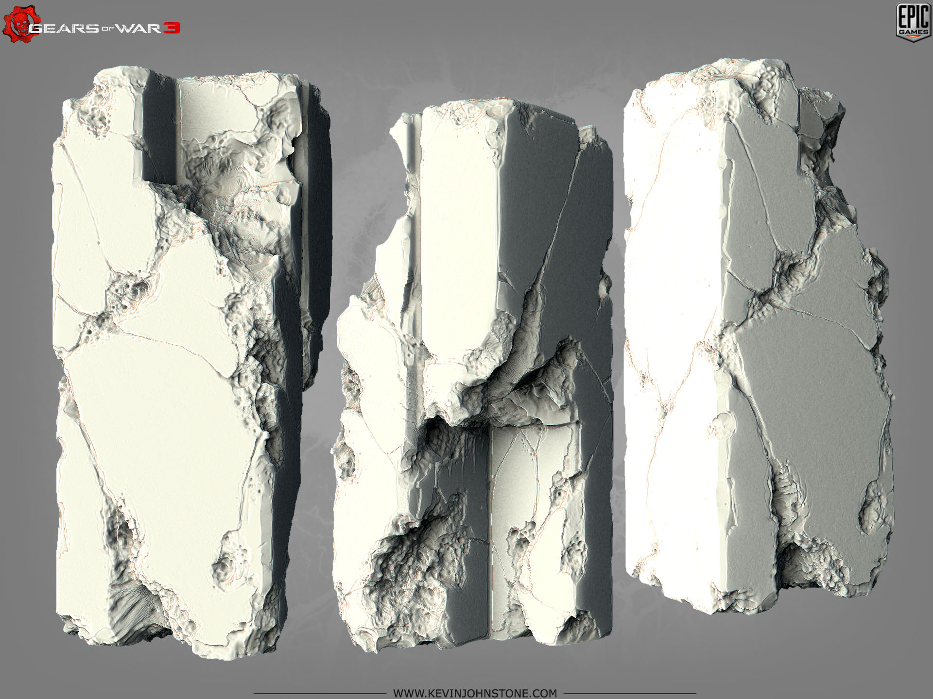

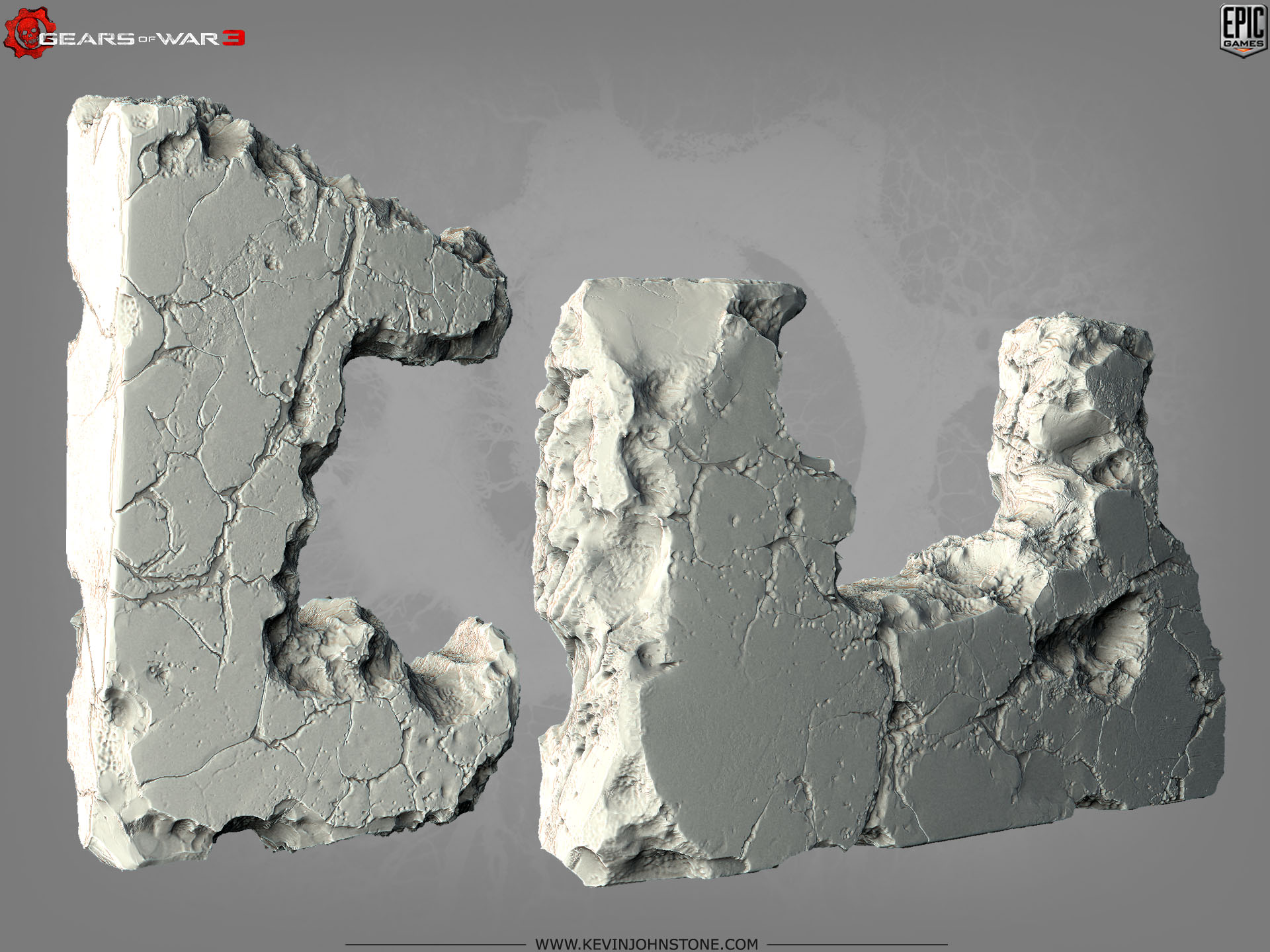

[HR][/HR]Some Rubble Blocks. I made a few of these for combining to create other meshs. They are always useful to have lying around and very relaxing to make.
you make it look so natural, just as a stone/pillar would be damaged in the real world. Very cool:+1:

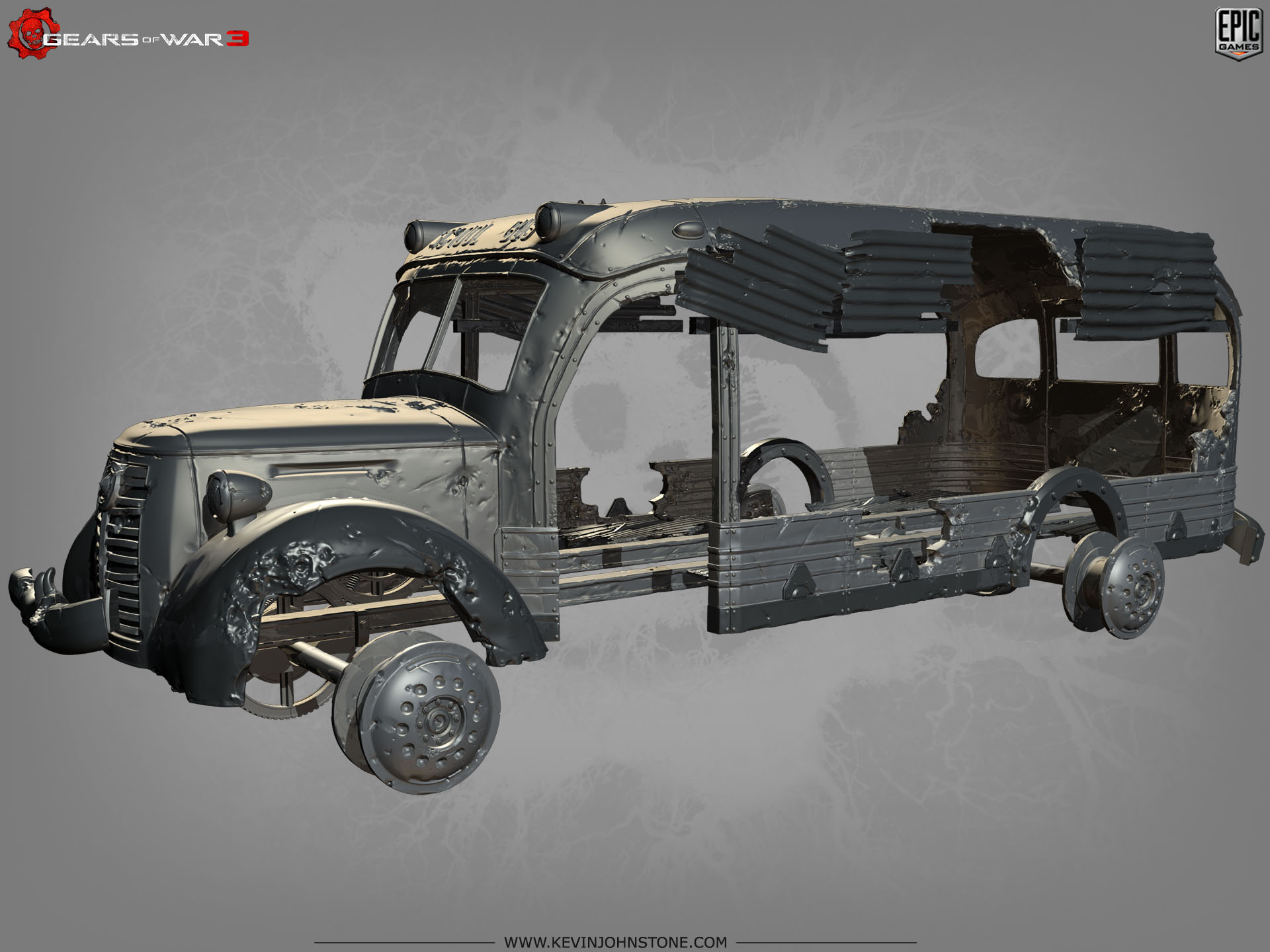

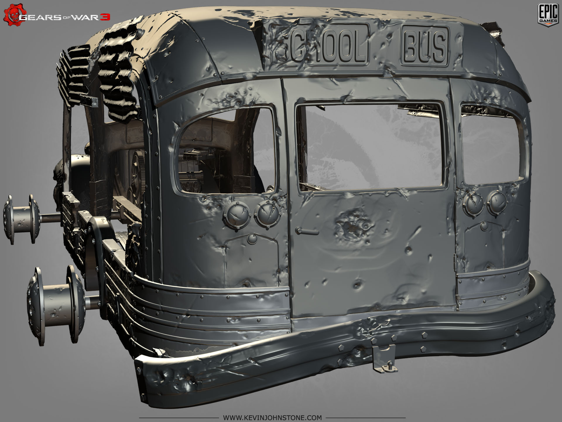

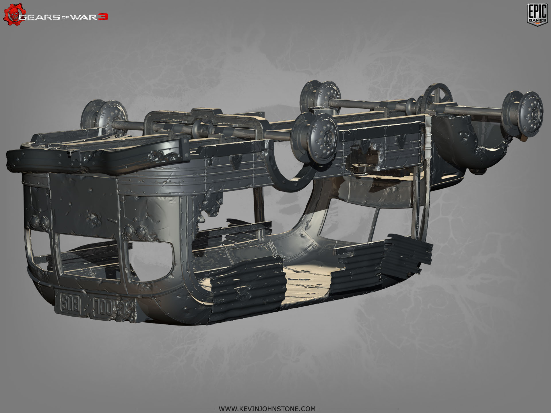

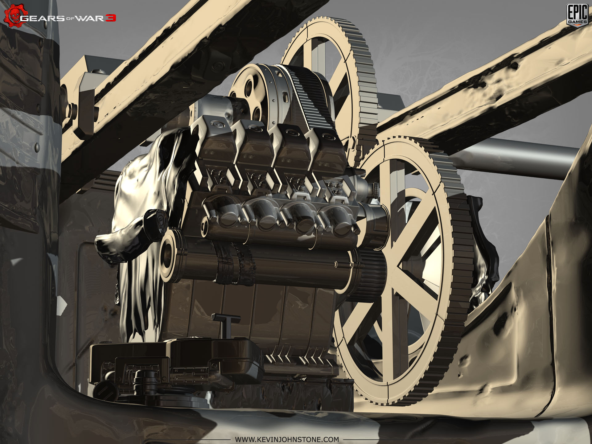

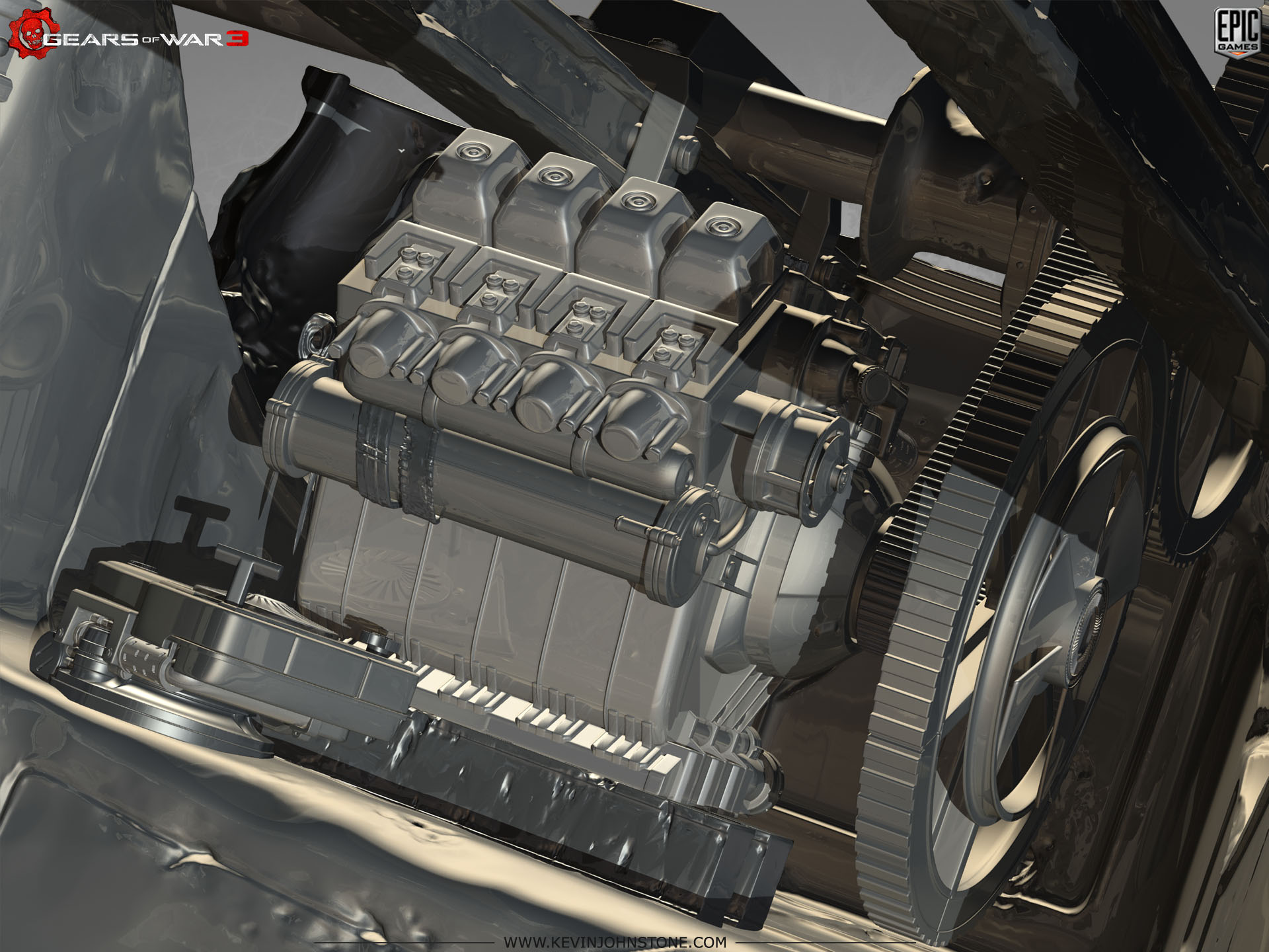

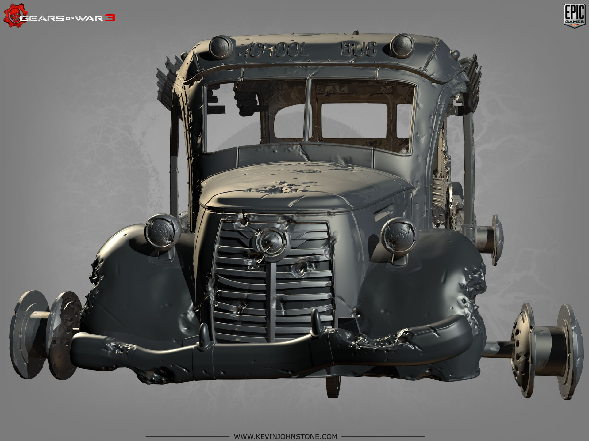

Below are some Hipoly shots of the Bustram. Lee Perry came up with the idea for using an upturned bus with a pulley system like a skilift in the Char level which was just brilliant.
It went through many revisions for gameplay reasons though and building it and rebuilding it nearly broke me over the course of almost 2 months to get it ingame.
Oh yeah, I almost forgot. At some point during the design I thought it would be cool to hook up a lawnmower starter cord tied to an engine that provided the power to turn the pulley system. I didn’t work out exactly as intended but it got in there and was a lot of fun :slight_smile:
I’ll try to dig up some shots of the final lowpoly meshs next time
