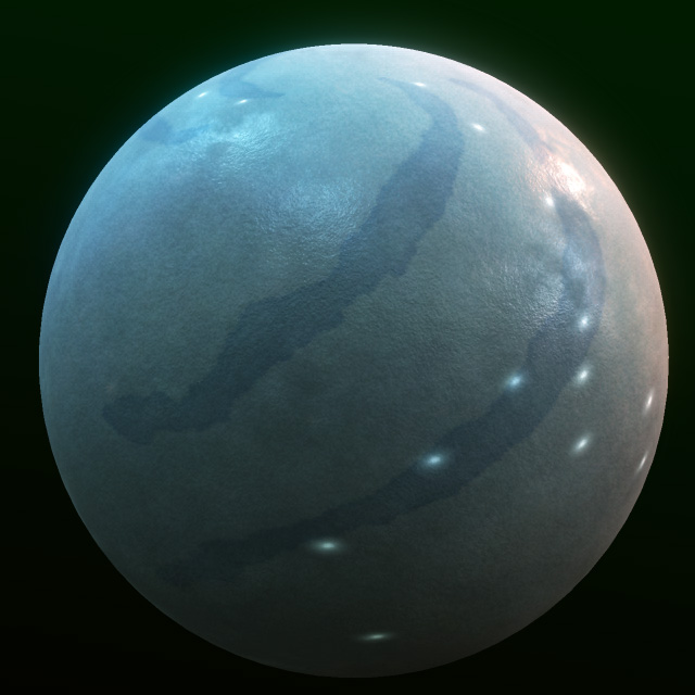

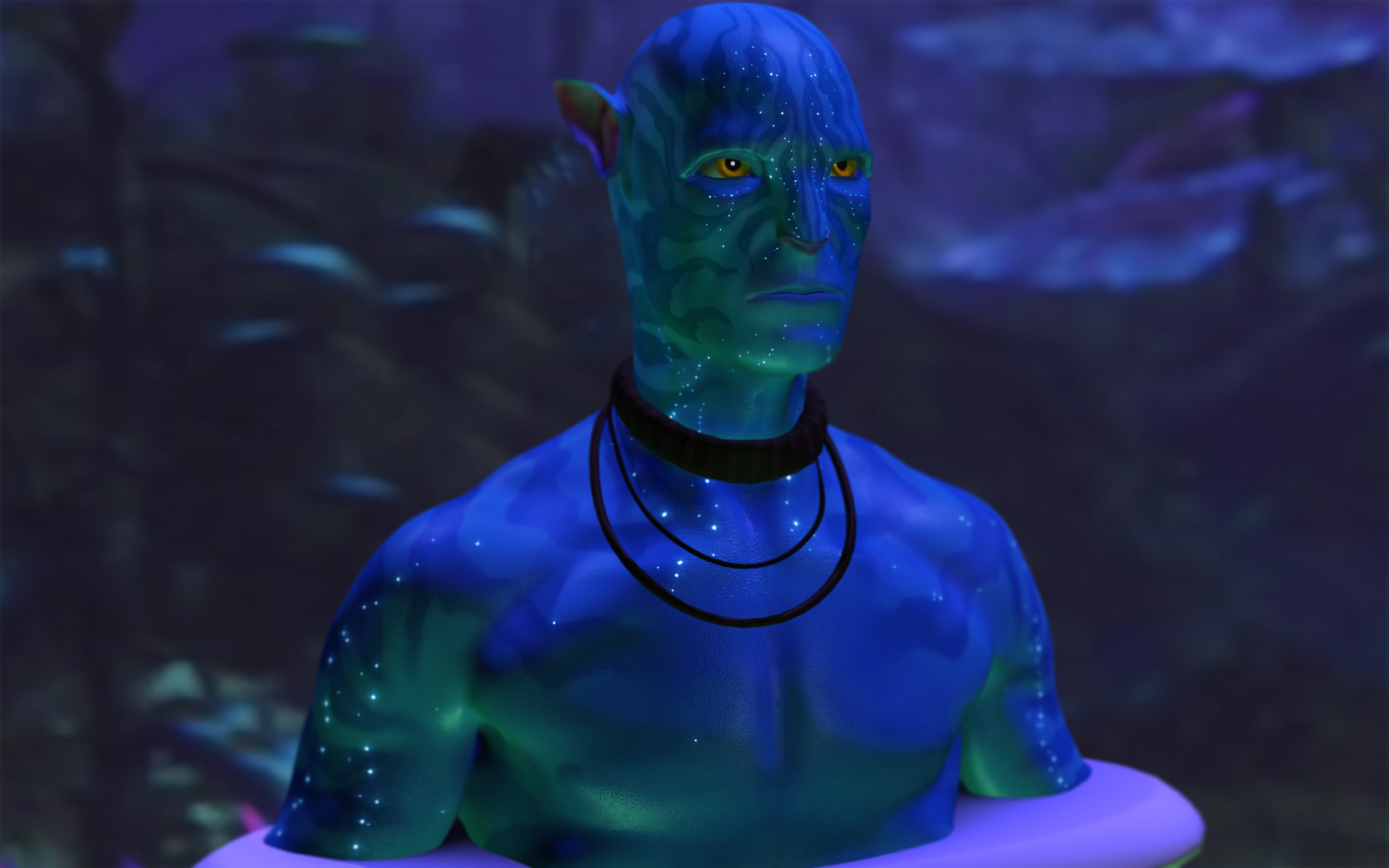

Well, I did some Mental Ray SSS Skin shader configuring (had to learn it on my own as there are no good tutorials i found) and got an alright setting.

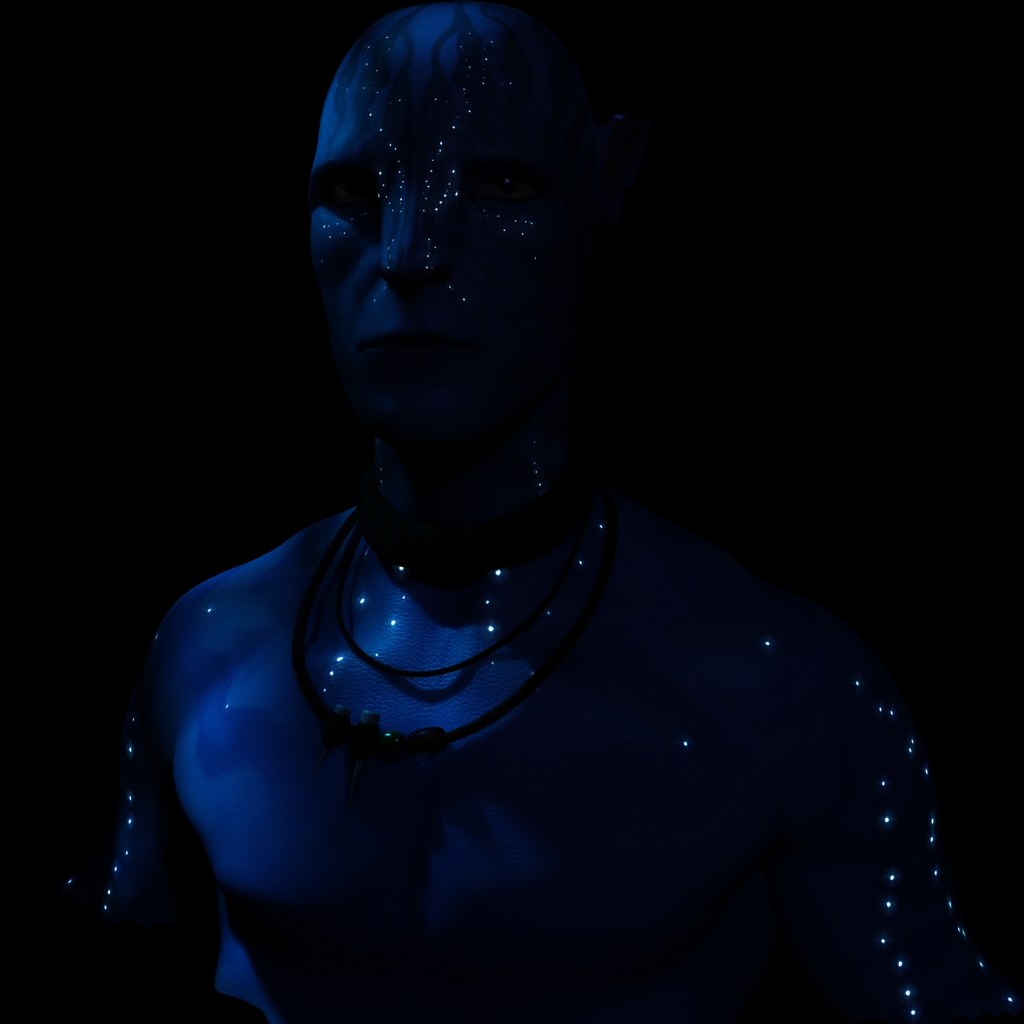

I also created the Subdermal, backsurface and emmissive as you can see in the following images.

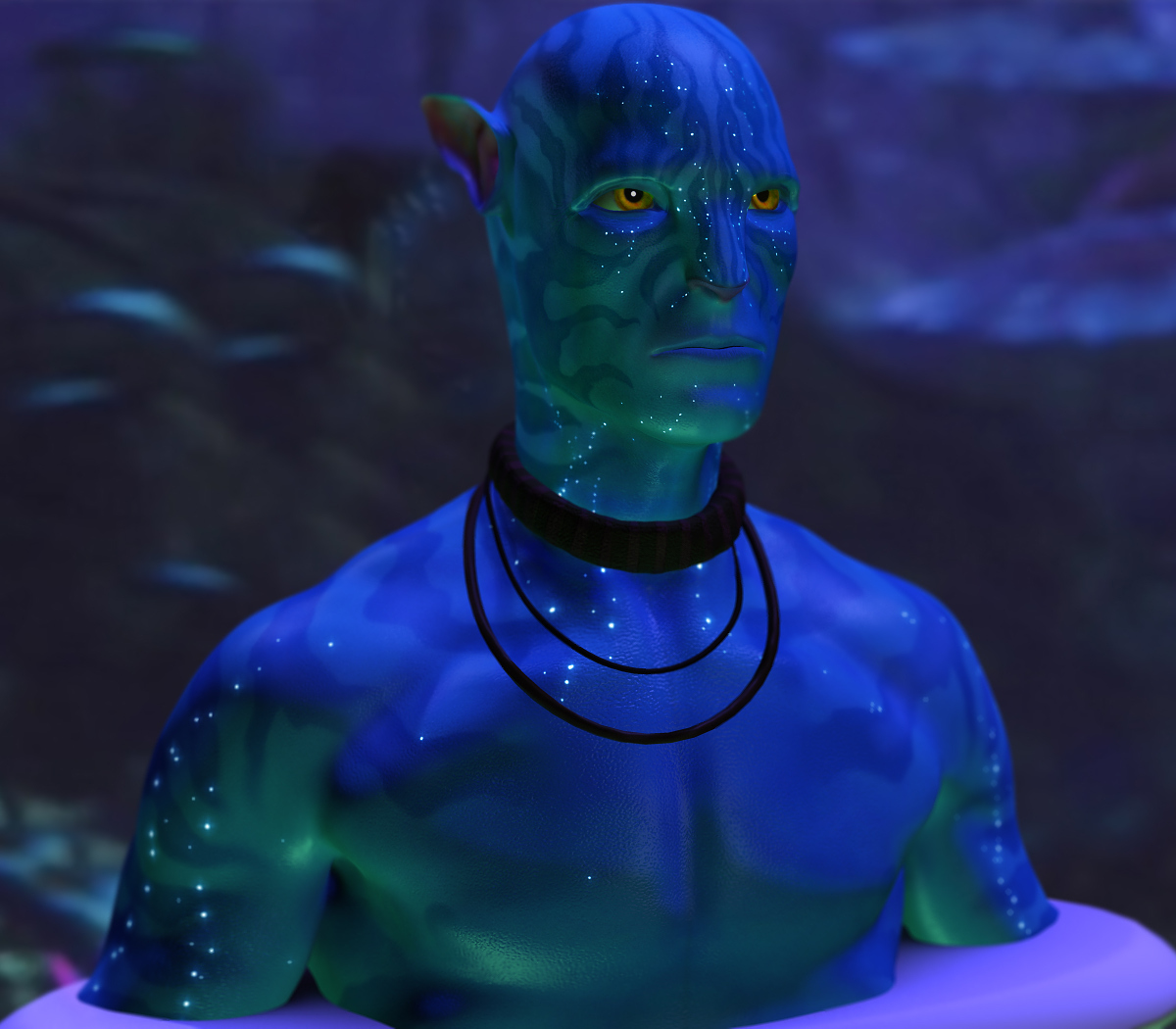

Done an avatar myself, but yours is much more accurate. How did you get the emmisive?? a setting under SSS Fast skin? Love the character’s eyes too, only notice that the look dull, probably cos the specular map for the cornea doesnt hasve a high enough value, or the scene is not properly lit. If all these are proper, then u could use a point light to finish it off.Was your base mesh made in Max, the sculpted in zbrush? Nice model overall

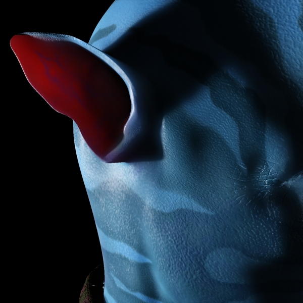

Nice work! Pretty close resemblance to the references! Only thing I see that still needs a lot of work is the ear. Try to find good animal reference, like the ear of a dog, cat, horse to create a more believable morphology. You could also use the movie, or other reference from the movie.

SSS materials
For the skin setup (mental ray for maya user, max should be almost the same) you should use something like this:
Overall/Diffuse Color - Plug a Arch&design (mia_material)
You should give this material a little reflectivity so it actually reflects some of the environment, and some glossiness.
This layer should be white, with additional color for the white glows over the skin.
This layer is the one who has bump/normal map.
Epidermal layer - Texture
Here the blue stripes should be plugged, this way the SSS shader blurs them a little, and makes them react correctly to the lighting
Subdermal layer - Texture
A blue blobby texture.
Back scatter layer - The default red works fine
Yeah the emissive is under the SSS Fast Skin Shader. I made an image to explain how to do it.
[Emissive Help.jpg]
I used the basic head model from the zbrush downloads centre, and used the demosoldier’s base mesh for the body. I exported both to render in 3ds max 9.

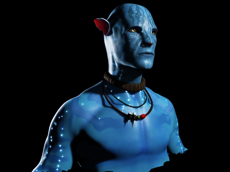

Here’s a large image render. I don’t think i’ll bother with hair, so this is basically the final image.

nice job. I love how your taking the character
Nice !!!
wow 16 and already this good…to bad i wasn’t so good at my age…i’m 18 now but much to late…
keep them coming dude
