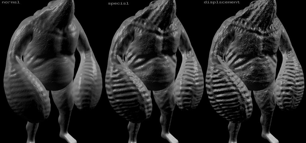

A very quick & high quality alternative to Displacement & Normal Maps (by Rastaman)
Thats the old versions to create displacement map I think.
Not 100 sure, but it might be less assurate than the create displacement map plugin.
I dont know if the morph thing has any effect, but if you mesh change, it might accentuate a bit the volum depth…
I dont know how you generated and rendered your normalmap VS the disp, but theres no reason why you would get such a big difference…
if you use Zmapper, with the same texture size, you should get accurate and fine normalmaps…
the reason having 16-bit displacement is because we can have value like that. with accurate intensity.
it might look shallow grey in photoshop, but with some correct setting in mental ray render, it should stand out without losing the quality.
try to play and save your zbrush 16 bit displacement, and put very high contrast on it, you will get same result without losing the quality ( because its a 16 bit). and you can use that for good base diffuse color map. :slight_smile:

Actually guys, I have been testing out this Gray “Special” map all day, seeing what I can do with it. I’ve been using it to actually generate a very beautiful normal map, using nvidia’s filter.
The reason I like this map so much is because of all the things you can do with it, being a grayscale map…and for some reason, it retains all of my details, down to the tiniest pore even…
Using the nvidia filter, I converted it to some really fantastic normals, after tweaking a while.
Yeah you might be saying “Why not just make a normal map based on your high poly in Zbrush?” Well, I’m not sure why, but it just doesn’t retain the details for me like it does in this disp / special map. I actually end up combining the normal map and this disp map and my stuff is looking phenomenal…with every tiny scratch included, without any geometry actually having to be displaced!

another example
(exported normal,special,displacement maps and applied as bump in max, not sure if i did it right)
