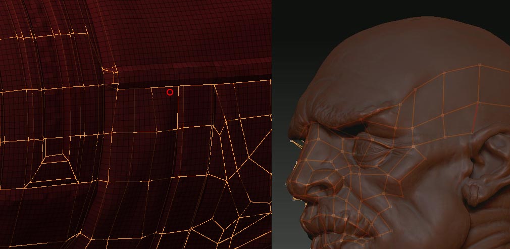

I’m having the same problem. I keep seeing tutorials and demos with the retopo tools but can’t seem to get the same results. I looked through the posts and it SEEMS that it’s a zb4 thing. Is that really the case?
Here’s what I keep seeing… and here’s what I get (mine on the left)…
