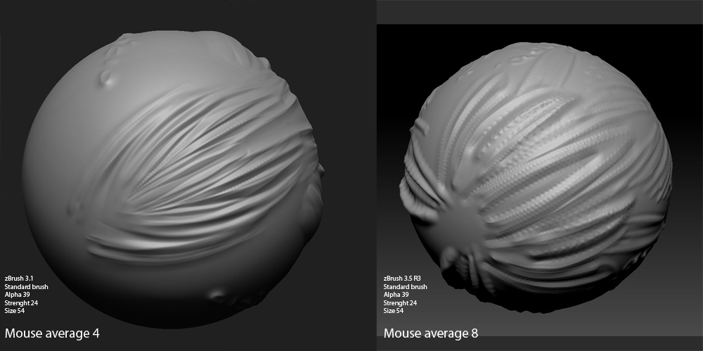

Brush strokes more "segmented" now in 3.5? (See page 5 for more information)
I just installed the R3 here at work expecting this lag on the stroke to be fixed by now. Sadly it is not.
I used the R2 three times and closed it down for good. Was kinda excited with the new release, but meh…
Here’s a image to compare zBrush 3.1 to 3.5 R3. Same machine, same brush, and lots of difference.
Back to 3.1… :frowning:

I assume that is the new “Fast Samples” function in Brush> Samples. It is disabled by default with the Standard brush, you have to move the sample radius slider a bit to enable it.
In either event, the only effect I was able to coax from this was “bad” vs. “Slightly Less Bad”. We need some sort of control over spacing, not sampling, like with the lazy mouse.
The only thing Ive been able to do that made any meaningful difference, was to crank the “Preferences> Performance > Mouse and Tablet Samples” all the way from 100 to 1000, and this really produces a modest increase in quality. Still nothing to compare to 3.1.
I did that too but I still have to draw slower to get the same stroke quality I get from 3.1…
